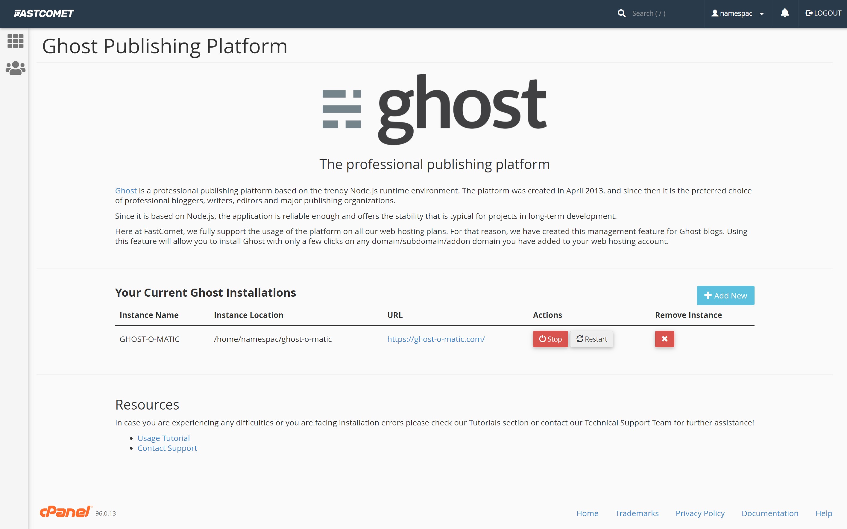

For creating (and stopping/restarting) the Ghost instance I am using their Ghost Publishing Platform interface:
 ![Ghost-O-Matic-FastComet-Cpanel-2021-07-24-140701](https://us1.discourse-cdn.com/flex015/uploads/ghost2/original/2X/2/2e18a9bef31f73b76b9322f343551bc4112f9114.jpeg)
