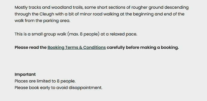

Yeah, on all posts, both on desktop and mobile:
However, did some debugging. It only works when I have my adblocker on.
I then had a look at my console, where I saw loads of errors that certain scripts couldn’t be loaded. So I turned my adblocker off. Tada. PayPal buttons gone:
