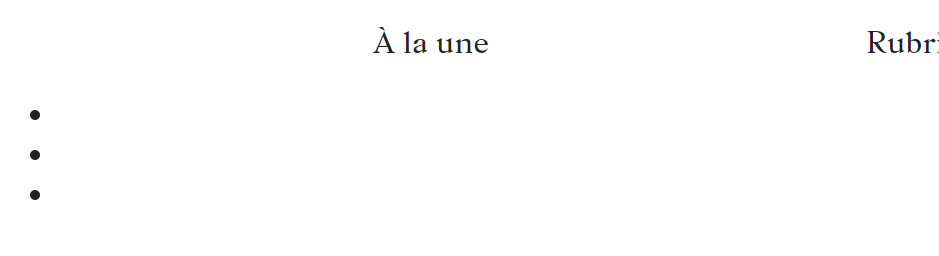

Also changed the content of my tags.hbs file to this:
{{!< default}}
<main role="main">
<ul>
{{#foreach tags}}
<li>
<a class="link f2" href="{{url}}" title="{{name}}">{{name}}</a>
</li>
{{/foreach}}
</ul>
</main>

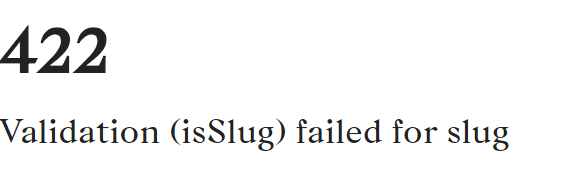

Problem is, when uploading the new routes.yaml and trying to access the /tags/ route, I’m welcomed with a 422error and a somewhat cryptic message:
There’s obviously something wrong in my configuration… but what ?
Would anyone know what this message is trying to tell me ? Have I done something wrong in my routes.yaml file or elsewhere ?
