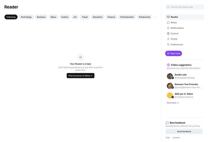

Hey @Hugh_Evans, the curl command is a red herring as the endpoint requires authentication. As example, it returns the same error for my site, even though I can view feeds correctly in Ghost Admin:
curl https://sagzy.io/.ghost/activitypub/v1/feed/reader
{“error”:“Forbidden”,“code”:“ROLE_MISSING”}
What do you see when you open the Network tab in Ghost Admin?

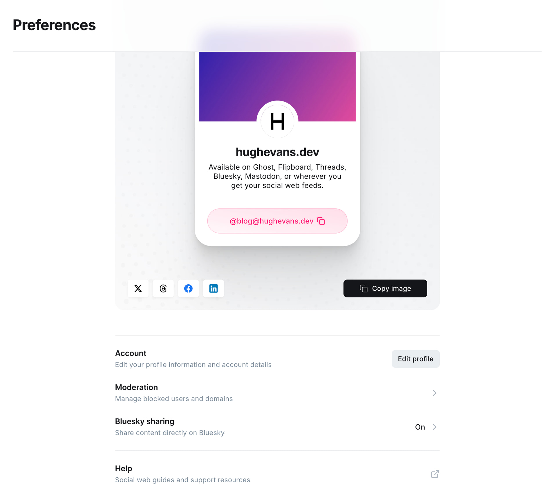

Hey @Sag ,
Ah ok that makes sense. Here’s what my network tab looks like at the moment, looks ok so far and I was able to setup my account and bluesky mirror fine - it’s just that the test blog hasn’t been picked up / posted yet.
It doesn’t backfill with older content. You might try unpublishing and republishing the old post, or publish something new?
It should have been published since I restarted Ghost with the fix you shared @Cathy_Sarisky (thanks again for that!) I will unpublish and republish it now though just to double check test
Cool - I was also able to follow your account, so I think we’re past the initial configuration problem!
As per why your post is not being federated, this is odd. Just to be sure, could you also try publishing a new post?
That works! Thank you so much @Sag and @Cathy_Sarisky! I really appreciate your help and patience
