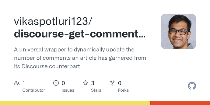

I wrote a wrapper a couple years ago that fetches the comment count for a set of nodes:
You could wrap this with a link to the discourse instance + slug
(eg talk.my.blog/t/{slug}). Discourse does a pretty good job of finding the proper topic

I did some searching and stumbled upon this very GitHub repo, if there was fire reactions I’d be clicking it right now :fire:
Yes, I saw that repo that is why I CC’d you as a domain expert :slight_smile:.
