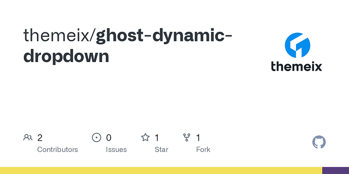

@electricescape here is another method that might work for you…
Unfortunately that code isn’t working in the Liebling theme. It just comes up with the full [has_child] or [subitem] written into the menu menu name, and no dropdown. I can’t switch back to Casper because that’s broken and doesn’t seem to want to download the latest working version.
Yes so I got Casper working, and the dropdown works. It just doesn’t work in any other theme other than Casper (I tried a few).
Do I just add the includes into the code injection header after I put the two files in the css and js directory??
