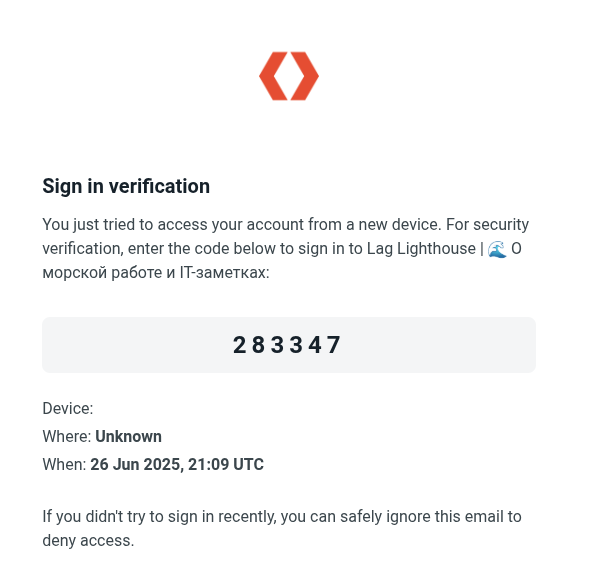

Login and password correct. I’ve got email with verification code. And also if login and password incorrect, after have a message about it. Here is everything is correct.
I use cloudlfare for domain. Trying Development mode. Also on server try to disable firewall. Nothing helps for now.

I am facing this very same issue. On the logs, via ghost log -f I get:
CODE: 2FA_NEW_DEVICE_DETECTED
MESSAGE: User must verify session to login.
I don’t think ghost backup will work for me. :confused:
As per Cathy_Sarisky’s answer this is a bug, so we can’t do nothing here. Only wait for new realese and hope this bug will fixed.
I had the exact same
I have 3 emails in my inbox with the verification code, but not way to enter them into the CLI for ghost backup.
What version of Ghost-CLI are you using? The latest CLI version has support for backups using a staff access token.
ghost-cli got patched recently to make this possible, but I don’t think the docs have been updated. So, you need to upgrade to 1.28.3, and then see feat(backup): support specifying backup staff token via env var by acburdine · Pull Request #1967 · TryGhost/Ghost-CLI · GitHub for environment variable to set:
