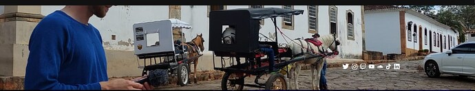

Problem
On “standard” sized screens/viewports (1600 × 767, and even on phones) my banner image appears as expected; however, on extra large screens (2560 × 1307), the banner gets moved up and results in ‘chopped off heads’. I am using the Liebling theme but I feel that this isn’t a problem relegated to that theme.
Here is an example of a “normal” screen (1600 × 767)
Here is an example of a “large” screen (2560 × 1307)

I’m lost for the best way to resolve this issue and would greatly appreciate any tips or pointers for working around the problem. I believe a solution could involve altering the m-hero__picture; however, I also think the problem could be deeper and that I may be better served to just take new photos and replace the current banner images.
