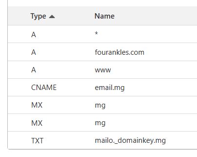

Hey Martin,
I cleaned the records in cloudflare and retried swaks and got another failure at mailgun. Here’s the new configs on cloudflare:
Capture
I’m probably missing something or I’m not waiting long enough for the changes in DNS.
F
you also need an SPF record .
TXT “v=spf1 include:mailgun.org ~all”
Also, double check the domain key, and in the Mailgun settings, make sure you have a green check mark against all the DNS entries.
Sorry, this isn’t quite my knowledge area, but I’m not quite sure what goes where. I make a new entry (TXT), then I need a name and then content. I assume the spf is the content? But what’s the name?
Again sorry, I can’t find a guide for this content specifically.
F
ps. Also All verified at mailgun.
Create a new TXT record, put @ in the name, and v=spf1 include:mailgun.org ~all in the content box.
