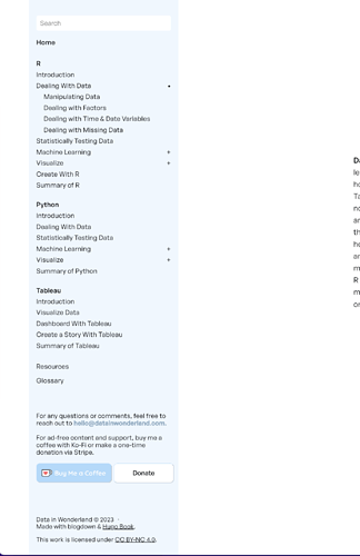

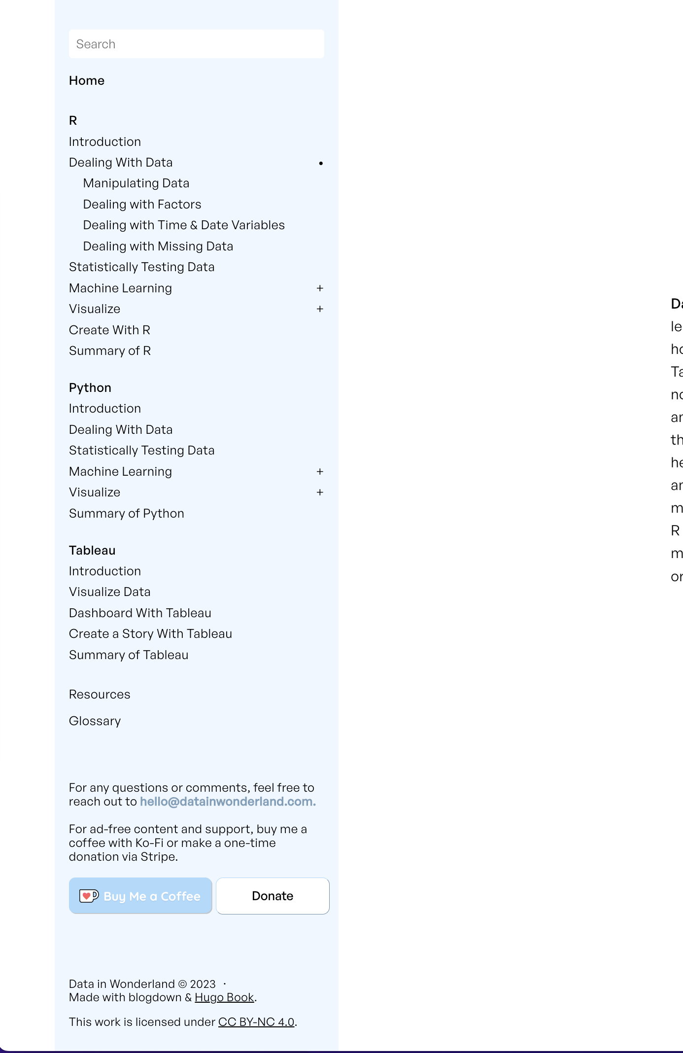

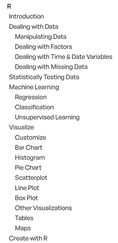

This is what I originally had in the Hugo theme:

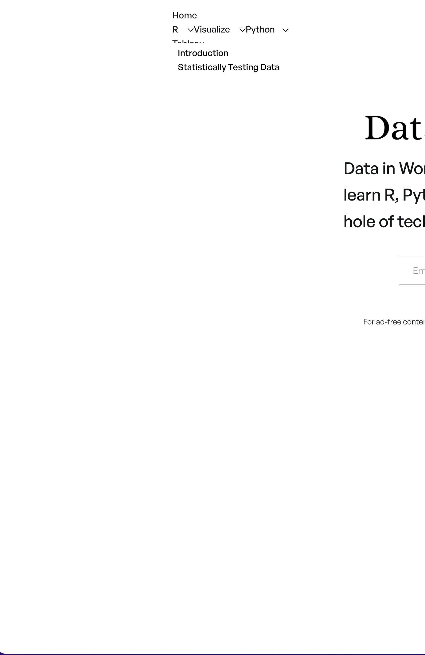

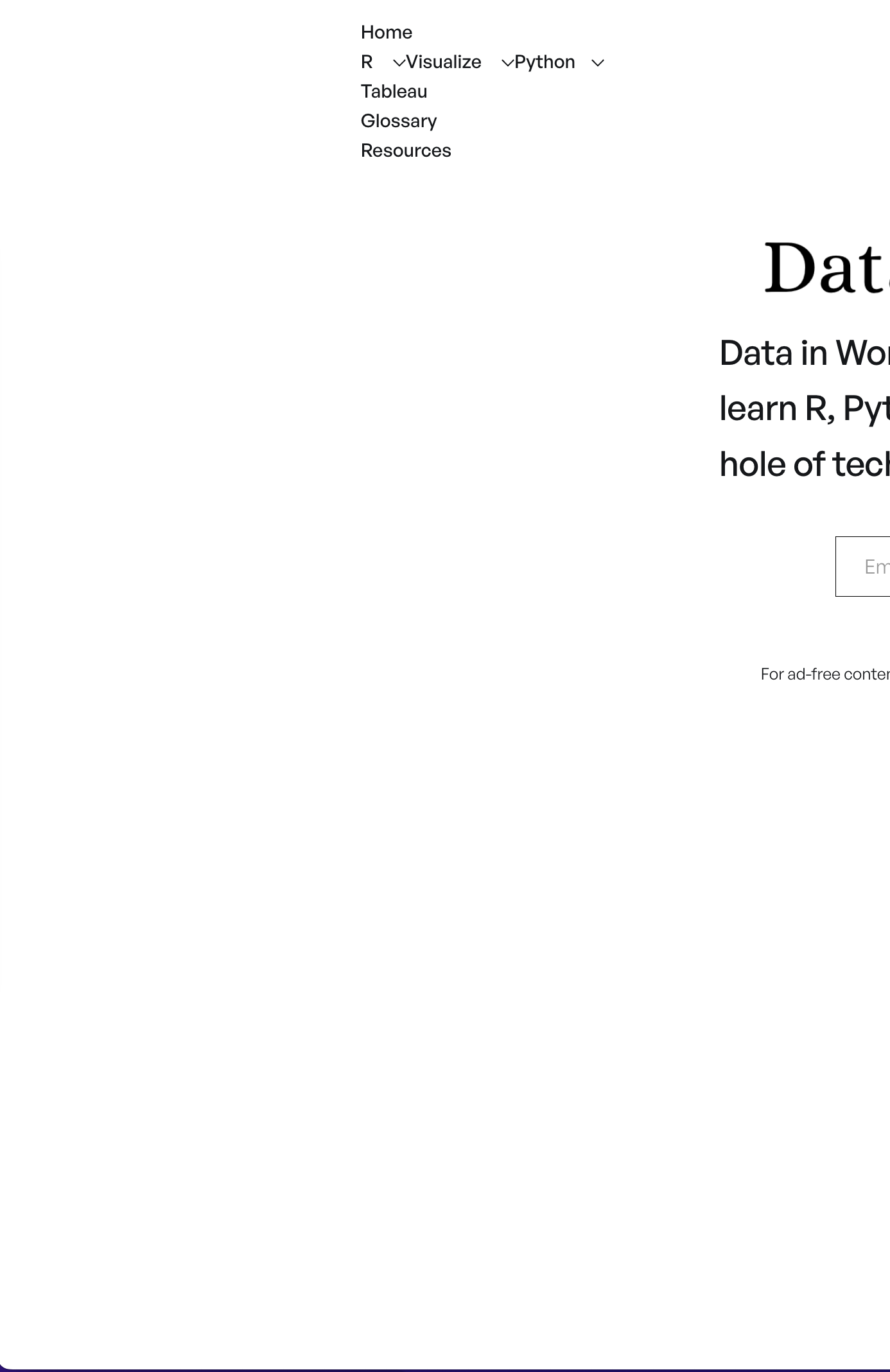

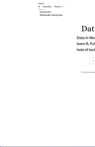

This is what I currently have:

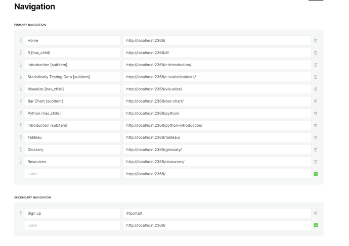

After inputting the code from the mentioned post, this is how I tried to set up the navigation in my admin:
Ideally I would like to have my navigation have the same structure and similar look to what I originally had in the Hugo theme. Each plus sign contains more categories under another topic, an example can be seen under the R section Dealing with Data.
If it is not possible, is there any other way I can organize the information? Thank you in advance.

@denvergeeks Is there a way to make the submenu item that has children toggle rather than hover? For example, I would like the Dealing with Data, Machine Learning, and Visualize section (shown below) to toggle rather than hover when you select the mentioned topics. Is there a way to do that with the ghost-dynamic-dropdown?
I’m sure there is a way to do that.
I would contact @themeix, he is very reasonable with his rates.
