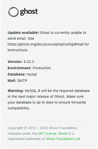

After a fresh installation of Ghost in Azure server( Ubuntu 20.4.3, Ghost: * Version: 4.32.3) , the mail function does not work.
Here is the config, also tried "secure": false, still it does not work;
before using this config, the default method “direct” also does not work.
