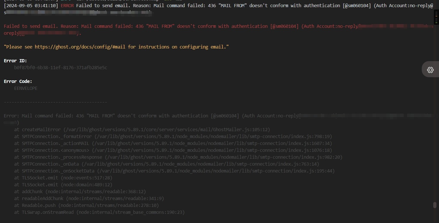

ERROR Failed to send email. Reason: Mail command failed: 436 “MAIL FROM” does not conform with authentication [@ sm060104] (Authentic Account)
The same email configuration, when I use URL: http://ip:2368 The sending was successful

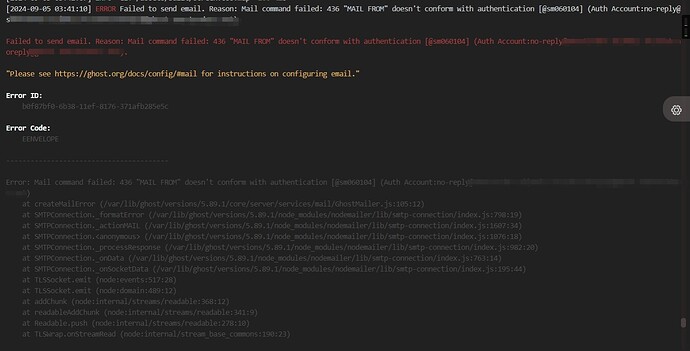

When I use the domain name, the email still displays the same error message as shown above: Reason: Mail command failed: 436 “MAIL FROM” does not conform with authentication [@ sm060104].
I changed the url: http://192.168.16.27:2368 ==> #url: https://ghost.smartorders.net,
Email can be used normally

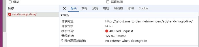

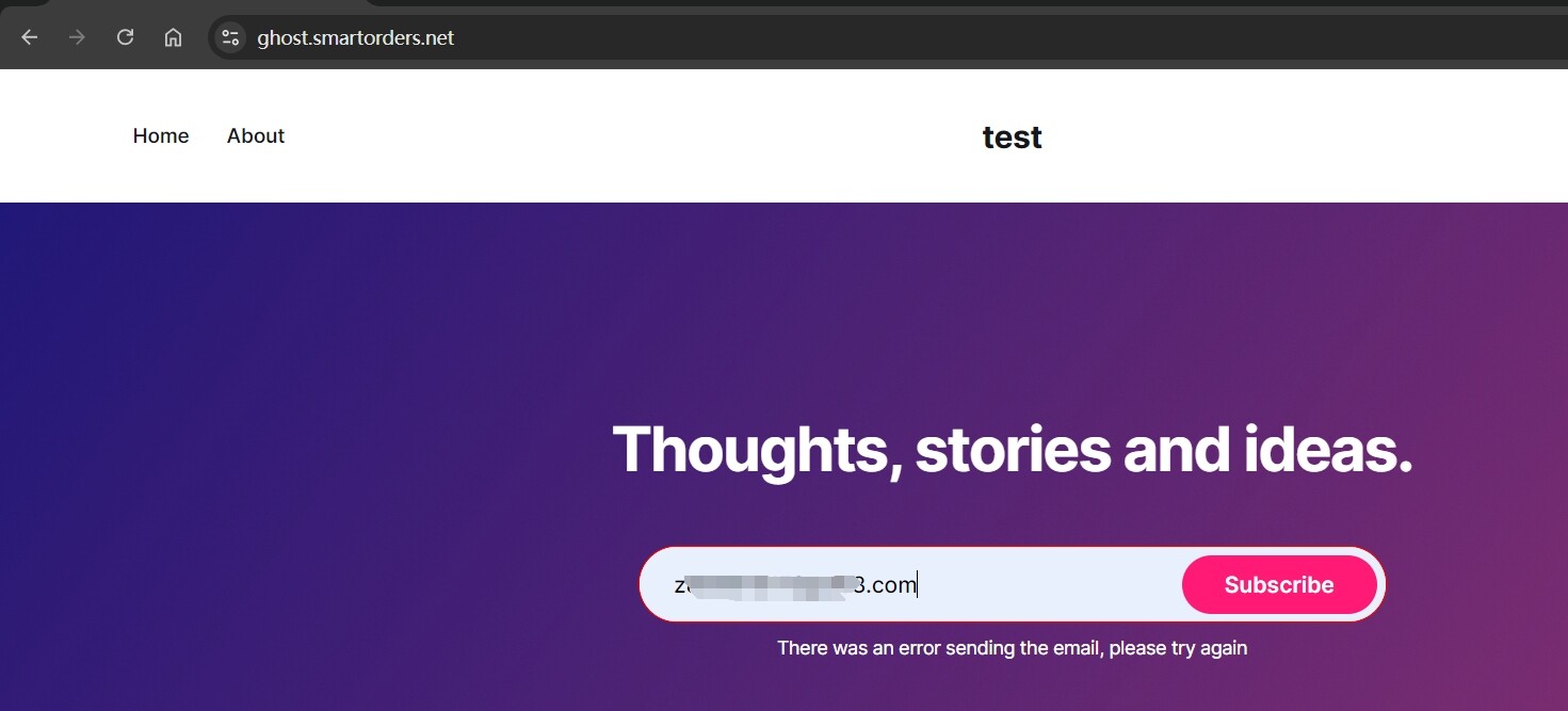

After trying to send emails many times, I only get an error when subscribing. I can send test emails normally in the “https://ghost.smartorders.net/ghost” backend. Is it a problem with my configuration?
I am using network_made: ‘host’, using the host port, which can be accessed. Currently, I have found an error message when sending emails to subscribe
“mail__options_service” is not set
I don’t know how to set the type of mail__options_service on Alibaba Cloud, but when I don’t set it, I use url: http://ip:port At that time, emails can also be sent normally. So I think this configuration has nothing to do with the domain name?
