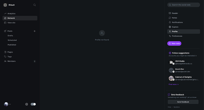

Hi there, using Ghost on PikaPods. It updated to 6.0.0, the Network tab got added under Growth. It displayed the initial walkthrough, but after that, none of it seems to work.
The Reader says Oops, Page Not Found. Profile says Profile Not Found. Tapping Follow on any of the profiles on Explore says Following, but after a second switches back to Follow. When I click Edit Profile under Accounts in Preferences I get a small white box that says “Profile settings” and nothing else. (Fwiw, I can’t find my account on Threads, so I’m not sure it’s been created – I assume it’d be @index@ravi64.com).
I’m posting here because I can’t even use the Feedback Widget – clicking on Send Feedback gives me “Error Loading Note”!
Does anyone have any ideas? I’m on PikaPods so I can’t run the update again or anything, and I tried toggling it on and off in settings.
