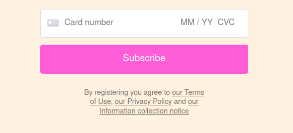

Checkbox + terms (stored in a db) or “like below” (Substack)
substack

The Substack implementation is actually not compliant with French laws. You cannot assume acceptance, people have to explicitly opt-in.
