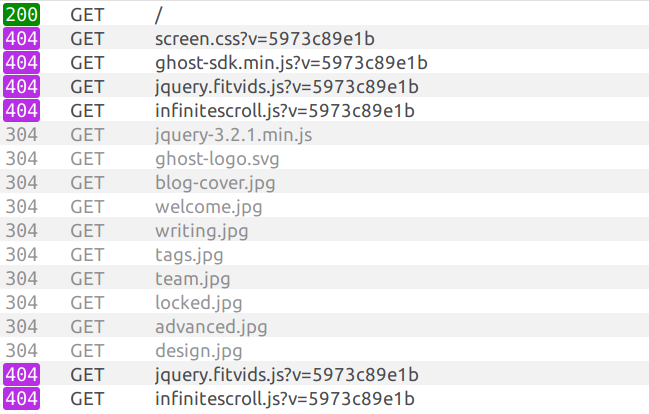

Also having a similar issue, reverse proxying through NGINX. Some content is not showing, specifically
Screenshot%20from%202018-05-31%2022-51-04
$ ghost -v
Ghost-CLI version: 1.8.0
Ghost Version (at /var/www/html/blog.site): 1.23.1
$ node -v
v6.14.2

Everything seems to be chmodded to 775, with the instance owned by the proper user. The instance is running, but some routes are not getting redirected to the proper file location, I’ve attempted to route them properly through Nginx aliases, but that doesn’t seem to be taking hold. No extra themes were added as this is a fresh install, default casper theme is being used.
