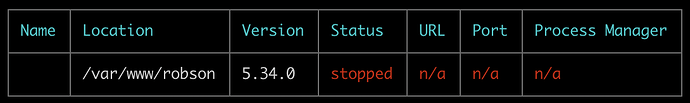

Do you possibly have a second install of ghost? Try ghost ls and see what it says…
Just one instance shown and it says its stopped! Yet I can see and modify the website

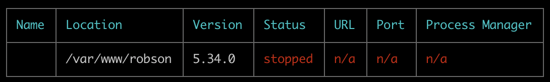

I am about to give up … I’ve restarted the server, rolled back to nodejs v18 (using nvm) and yet I still cant stop my running instance (ghost ls says its already stopped yet its still running; accessible via www and can be changed).
Nothing left except to build a new instance, only this time in a docker Ubuntu container.
EUREKA … I think I have solved the problem. It appears that I installed nvm as root user. I followed this FAQ answer to remove nvm and reinstall it under my ghost install user: Using nvm with local and production Ghost installs
After reinstalling nvm, nodejs and ghost-CLI, “ghost ls” command now shows that ghost is running finally. so I am now able to run and backup and hopefully update to latest version.
