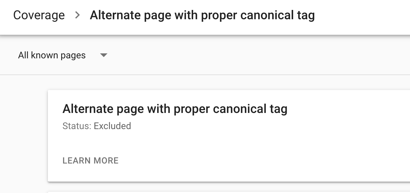

I have a Ghost blog with the default Casper theme. I noticed an issue in that my URLs are being excluded from Google’s Search… including my homepage :frowning:
This is expected with the amp pages but not expected (for me at least) otherwise. When I view the source of the HTML in this example let’s say, I see the below tag: https://www.foo.software/web-vitals-how-to-track-and-analyze-web-vitals/
<link rel="canonical" href="http://www.foo.software/web-vitals-how-to-track-and-analyze-web-vitals/" />
That doesn’t seem right. The canonical should not represent the actual page. In fact, I believe it’s causing the exclusion from Google.
Am I misunderstanding? Would others care to share what they think is expected?
