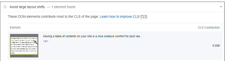

Casper Cumulative Layout Shift (CLS) on Google Pagespeed Insights is > 0.10
I am an happy user of the default Casper theme. I am using right now the 5.4.8.
Unfortunately, I noticed that on Google Pagespeed Insights, the theme has a quite low accessibility score, due to a cumulative layout shift that is usually higher than 0.10.
I was wondering if the developers have in mind to fix these issues in the future, in order to get a better CLS score:
main.gh-main > article # intro > div.gh-content > p
I have several of these paragraphs error in my page. They all add up and increase my CLS score. This happens also with other Ghost pages.
I am available for discussion about this with the Casper developers.
Updated with more infos about the error.
Can you share the page where you’re seeing this?
CLS (cumulative layout shift) is usually calculated separately from accessibility. CLS measures how much the page shifts during load. Minimal or zero shifting is ideal. Casper generally scores fine on CLS, so we need more information to answer your question.
I have discovered a solution to address the issue. The official table of contents ghost guide suggests using tocbot to generate a table of contents that appears on the side for desktop devices and at the top of the content for mobile devices. However, this approach is not ideal for mobile, as it violates Google guidelines by causing cumulative layout shift. To resolve this, I have added the following code within the style tag in the default.hbs header:
@media (max-width: 1300px) {
.gh-sidebar {
display: none;
By implementing this code, the table of contents will no longer be displayed on mobile devices or smaller screens. This ensures better adherence to Google guidelines and improves the overall user experience by also giving a positive CLS rating.
