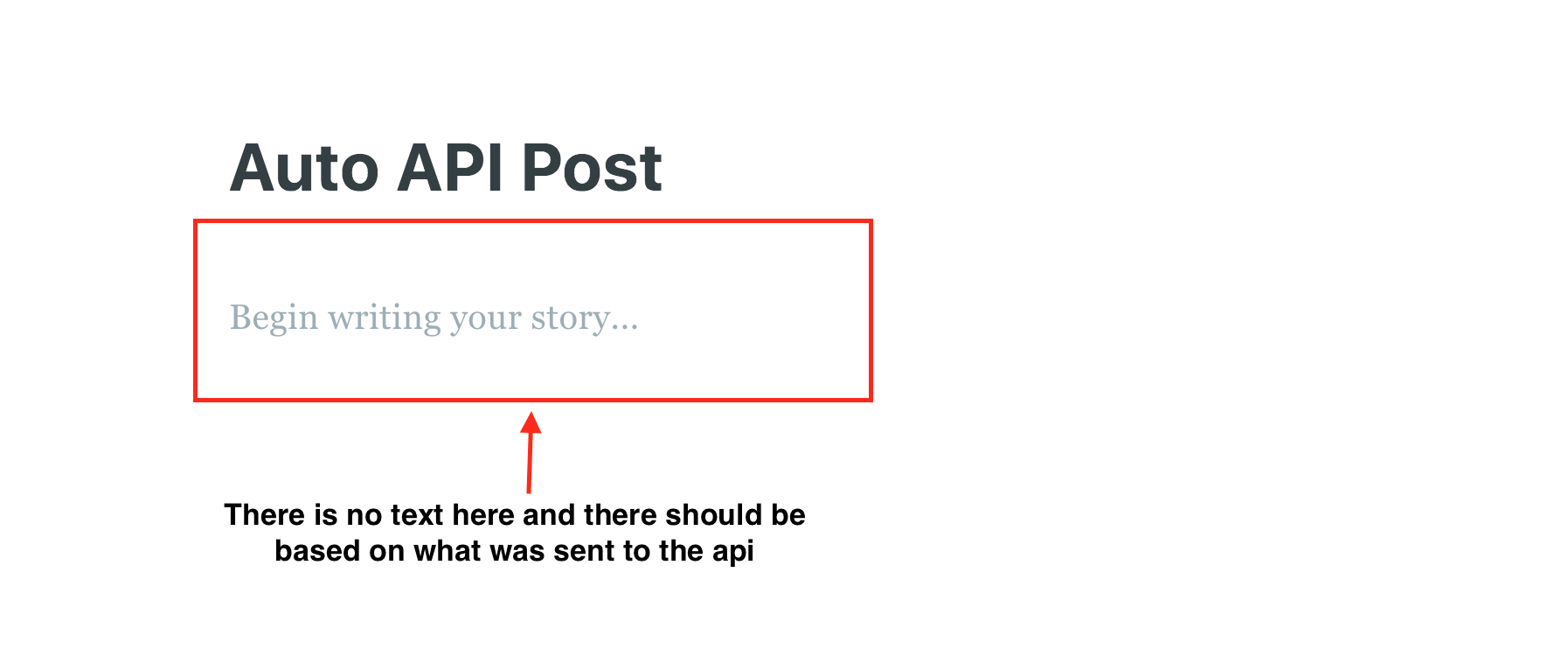

Additionally, here is a screenshot from GUI indicating that it is working, but there is no body text.
post_notext

Ghost stores posts using mobiledoc - it doesn’t store a post in markdown. If you want to use markdown, use the following template:
{"version":"0.3.1","atoms":[],"cards":[["markdown",{"markdown":"YOUR_MARKDOWN"}]],"markups":[],"sections":[[10,0],[1,"p",[]]]}
Replace YOUR_MARKDOWN with your markdown.
When you make the API request, make sure the mobiledoc field contains the content generated using the template.
