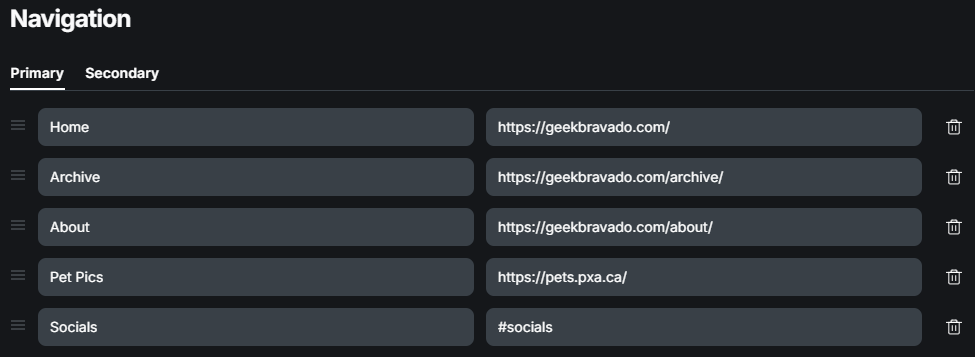

Everything’s working using your method, but there’s one odd, very minor cosmetic issue. When on the front page of the site specifically, the Socials menu option it lit up, like it’s indicating you’re actively on that page:
It only happens on that page, click into any other page or post and it goes out. I thought maybe this was because I had the front page referenced in the menu, but the link does just point to the anchor:
This might just be a limitation of how Ghost handles things and if so, that’s fine. I was just curious if there was maybe an easy way around this.

Seems to have done the trick! Is there a reason that only happens on the site’s front page? That’s the part that confuses me.
The theme indicates page you’re on, that #socials is just the hash, so it doesn’t count in the calculation of which page you’re on. Hence it thinks you’re on the socials “page” when you’re on the homepage. (I’m a little surprised it doesn’t have you on the socials page on every page, based on how your url is constructed…)
