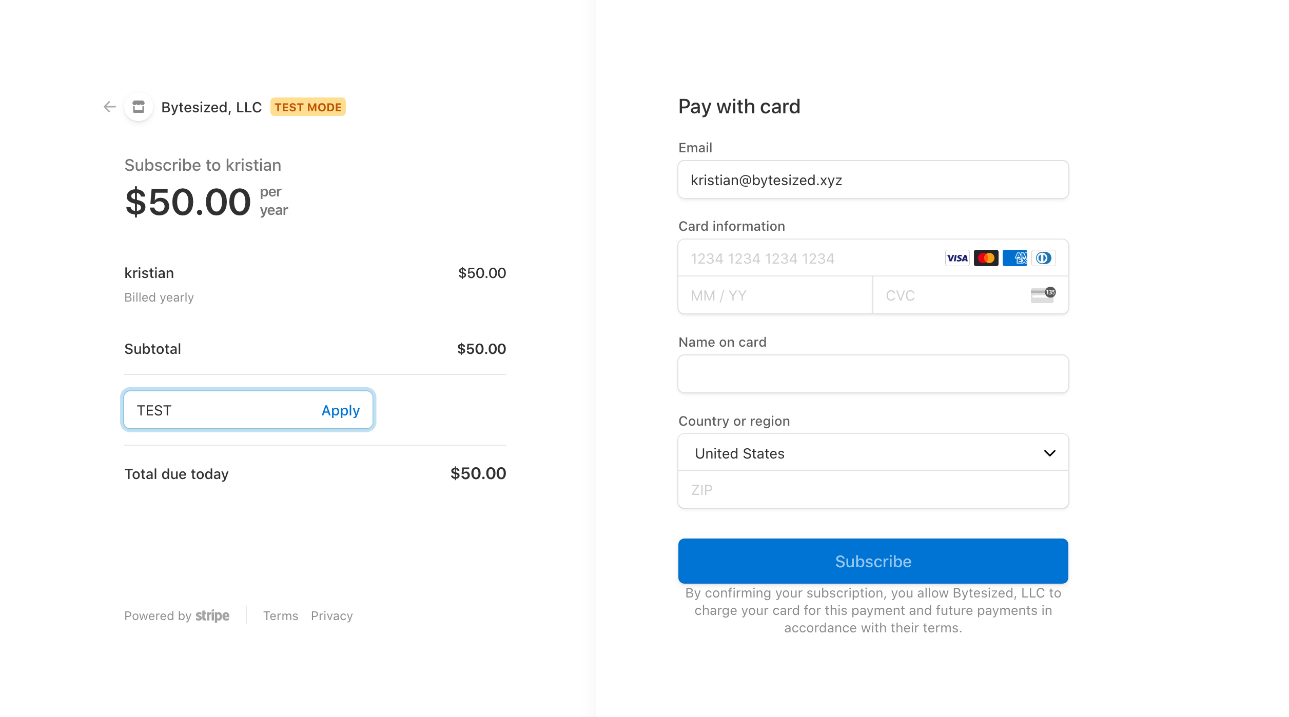

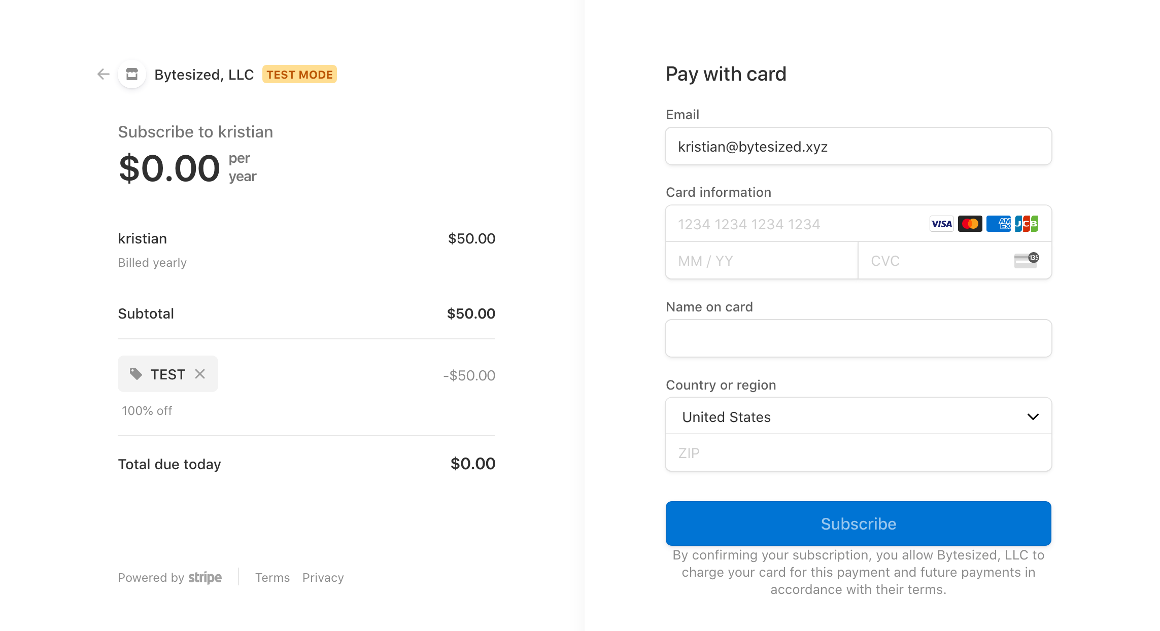

Stripe just announced coupon support for Checkout, shown in this tweet:
Maybe this fixes this issue?
edit: looks like it’s done with a allow_promotion_codes bool passed into the stripe checkout session call. i get that it might not be as clear cut as that (should it always default to true?) but looks like this is a good first step to this stuff landing. @robconery maybe if you’ve been looking at the source you know where this could fit in?
ok well i made a PR for this :)
Yep, I mentioned above 10 days ago that this was in progress and coming shortly — we’ve been beta testing it for several months.
The implementation suggested by @signalnerve is correct, and the question on the PR is the right one: Does it make sense for this to be on by default for everyone? At the moment: probably not.
We would consider adding it behind a config flag, to start.
thanks for flagging, this is cool!
