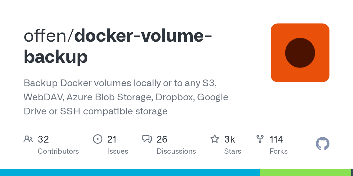

If you want backups, there are projects like these:
Though, the least complicated thing (without needing to update the compose file from ghost-docker) would be a cronjob that runs a shell script, backing up the MySQL database and content folder. I have instructions for that here. The upload to an offsite location is missing, but common tools like s3cmd can be your friend.
