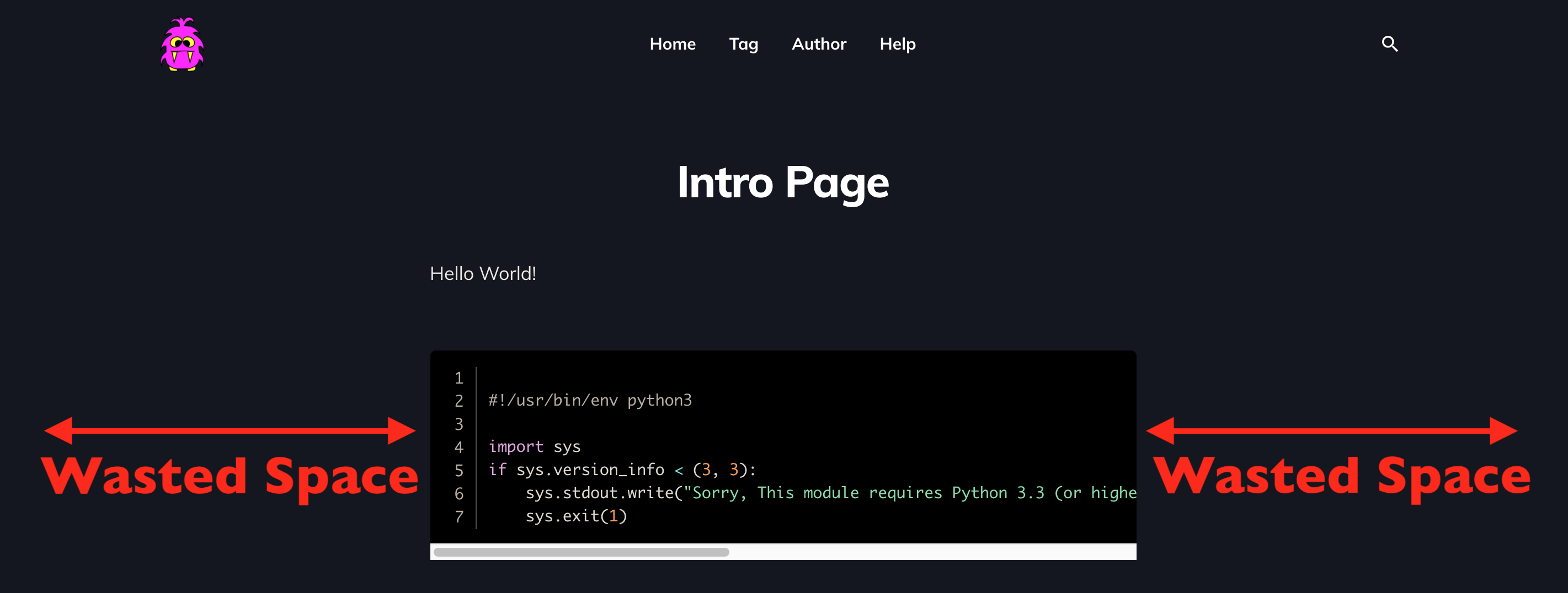

My only issue is that the code block is too narrow. See screenshot below:
Is there a simple way to make it (and all code snippets) wider?
@frakman1 yes a simple CSS override should do the trick. Can you provide a link to your page?
Unfortunately, it’s a private, internal page at the moment. It’s just a default ghost docker installation using the Dawn theme.

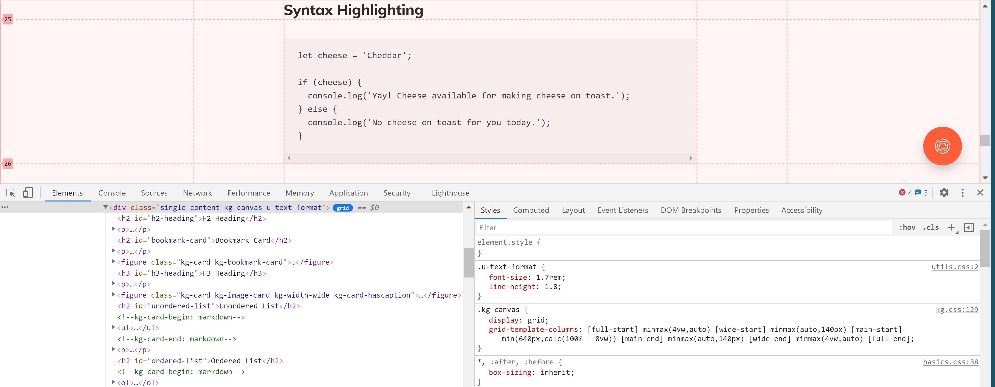

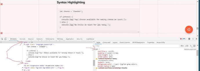

OK @frakman1 – so here is what I see in the Elements/Styles Inspector (CTRL-Shift-I) on the Style Guide for the Dawn theme, looking at the Syntax Highlight demo:
pre {
overflow-x: scroll;
padding: 1.6rem 2.2rem;
line-height: 1.5;
white-space: pre;
-webkit-hyphens: none;
-ms-hyphens: none;
hyphens: none;
background-color: var(--lighter-gray-color);
border-radius: 5px;
-webkit-overflow-scrolling: touch;
There are no right or left margins that I can see for the pre.

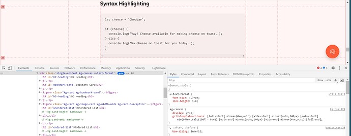

Instead, the width is being set by the containing div:
.kg-canvas {
display: grid;
grid-template-columns: [full-start] minmax(4vw,auto) [wide-start] minmax(auto,140px) [main-start] min(640px,calc(100% - 8vw)) [main-end] minmax(auto,140px) [wide-end] minmax(4vw,auto) [full-end];
…and so it appears that the grid-template-columns in the .kg-canvas class constraining the entire post content is the CSS that you will have to override (at least first) in order to widen your code snippet (pre) sections.
I hope this helps. Unfortunately not so simple in this (the Dawn) theme.

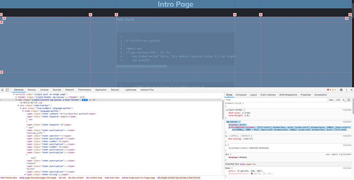

Thanks for digging into this. Yes, I follow you up until the .kg-canvas class but how do I change it just to test? The Inspect tool doesn’t let me edit the entries in the right hand window. I also have no idea what to change exactly. Is this the value that needs to change? min(640px or something else?
What Browser and Inspect tool are you using?
I’m using a Chrome Browser on a Mac. It looks like your screenshot. See my screenshot below. The highlighted section on the right is not editable.
Maybe try it in Firefox, or just try inserting your desired override in the header injection…

I was able to edit those fields in the inspector when I tried it again in a new window.
I got the code block to widen when changing the value 640 to something bigger in:
min(640px, calc(100% - 8vw))
However, when I changed the value in the file kg.css and reloaded ghost, it still shows up as narrow and with 640 from within the inspector. I just don’t get it.
Try clearing all of your caches (browser, server, CDN) and ghost restart
Thanks for letting me know, I’ve updated the link
Thanks. That did the trick apparently.
