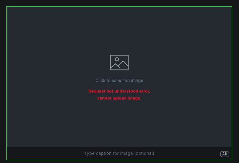

Depending on where I try to upload the image, feature image, in a post etc. I get different errors, but the ghost logs always say the same thing, ERROR on the POST 400, BadRequestError, Image processing failed, “Sharp wasn’t installed”. This is the latest to show on the UI after attempt to upload an image as part of a post, I actually think that the upload worked, because the image flashes in the background before this error message:
