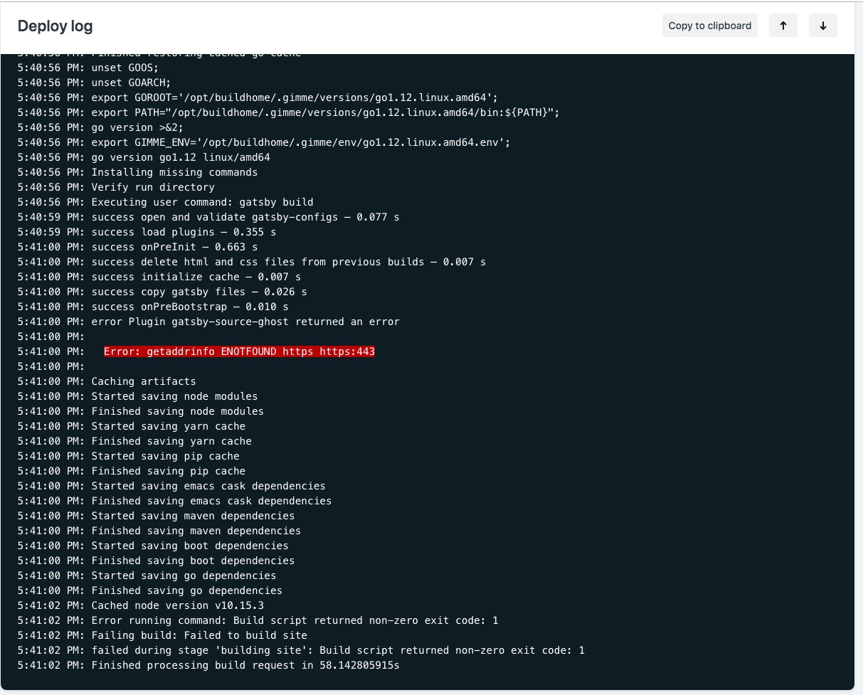

From my git repo I clicked Deploy from GitHub - pascalandy/ghost-headless: Ghost & Gatsby
Things are authorized but nothing is showing up here:
I’m confused.
Then I feel the best thing to do is to click “New site from git”.
I select my git repo. Things are building.
Then error here.
Thanks!
