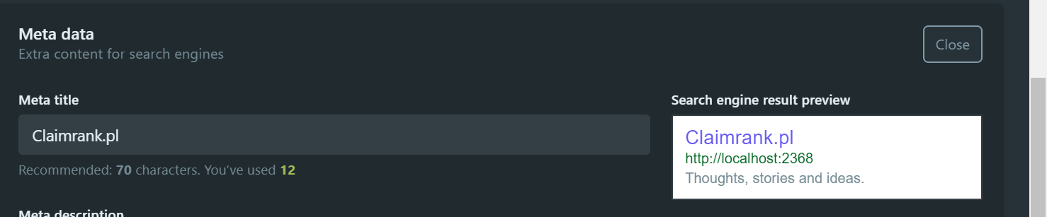

I have a problem - common one as I guess - with my Ghost installation. It is about a URL. During the instalation I set it to https://dev.claimrank.pl. But, I can see http://localhost:2368 instead of the URL in some places, i.e.
  • ‘under’ the Ghost Logo
  • in the admin panel - ‘under’ open site in a new tab
  • in the admin panel - metas settings / Search engine result preview
I followed instructions + some forum hints. I used ghost config url to set the URL. Actually it is correct there in the config file. But http://localhost:2368 is still present in the mentioned places.
I have even reinstalled Ghost.
What more should I do to get rid of localhost? :(

I restarted Ghost after each config change. As for config files: I did not change anything at all after installation :) There is only one file inside the root folder and it is config.production.json.
Moreover, I realized that localhost is present also in robots.txt file:
User-agent: *
Sitemap: http://localhost:2368/sitemap.xml
Disallow: /ghost/
Disallow: /p/
There is also some systemd info defaulting to 'local' when starting/restarting Ghost in the console:

I have installed Ghost one more time. I changed env type of the server for node.js (from dev to prod). And it works fine now. Then installed Ghost with dev server config and it has localhosts. Kinda strange, is not it? :stuck_out_tongue:
Could it be about the server configuration?
I think that’s why… you don’t have a development configuration, so it’s using the default configuration
