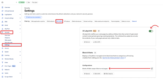

Enable Bot Fight Mode and various AI bot protection
You can block AI bots if you don’t want your website content scraped up by AI companies, and you can also enable Bot Fight mode for other bots in Cloudflare’s security settings. Here’s my setup.
While the above mitigations won’t stop all bots, it does help to greatly reduce the amount of bot traffic that reaches your site, which might help with your form issues.
