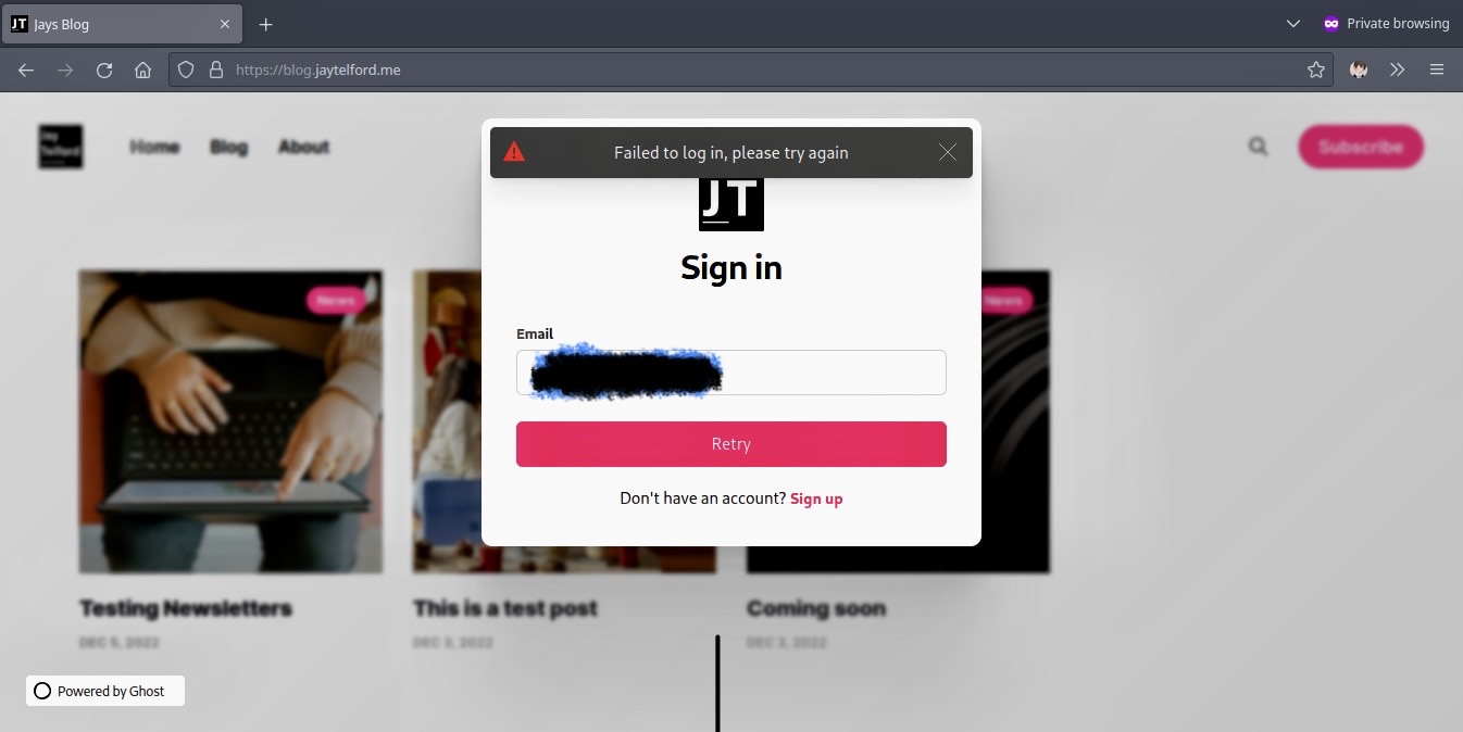

Everything seems to be perfectly fine settings-wise. The blog loads, I can log in to the admin panel, and I can even log in as one of my test users if I “impersonate” them with the link acquired from the admin panel. However, I can not log in as the user directly. Doing so gets me this error.
Trying to subscribe also gives an error message that says “unable to send magic link, please try later”. I can not get a screenshot of that message as it disappears quickly.
