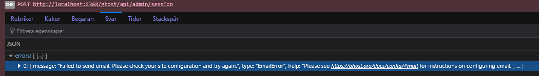

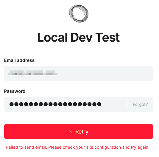

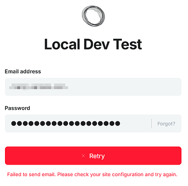

Once you’ve created the first admin account you’re automatically signed in to Ghost Admin. But, on the next login, Ghost will fail to send the email with the verification code.
The console log is more verbose and helpful.
This happens despite that the setting for requiring 2FA codes is disabled by default in Ghost Admin on the local installation.
