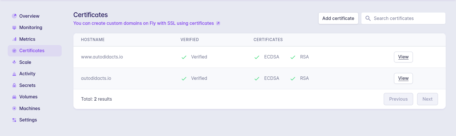

@curiositry I create new app using your tutorial and restore my content, everything is ok, but I have issue with my domain. I use cloudflare and when make new dns records pointing to new app my site dont open from my domain with error SSL handshake failed. Why is that? Do i need to point only ghost app, or db app too?
@Georgi_Pehlivanov Just the Ghost app. The Ghost connects to the MySQL app using Fly’s internal routing.
You added a certificate at https://fly.io/apps/APPNAME/certificates (or using fly CLI), and added the DNS records Fly told you to at the next step, correct? Does Fly show the domain as verified, and have checkmarks next to the certificates?
@curiositry I fixed it, but now I have some problems - how to change default app domain to my domain and not to fly.dev subdomain. When I open my site, everytime I click on the logo it open link in subdomain and not in my primary domain. My domain is in fly.toml
