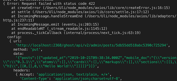

I am having troubles with adding a newly created mobiledoc segment to an existing post with a given ID. Authentication to the Admin API and the GET request (to pull out the updated_at field) work fine. Updating the title with the chained PUT request seems to work well, too.
However I am running into issues when I am trying to update the mobiledoc. I am using the html-to-mobiledoc tool https://github.com/TryGhost/Ghost-SDK/tree/master/packages/html-to-mobiledoc but I keep getting the error 422.
Can someone please tell me what I am doing wrong? I did spend a lot of time fiddling around with this issue.

@Ulineu the field name is mobiledoc not mobile_doc, I think that’s likely the problem.
One tip, it will help if you console.log the response content when you get a 422 error as it will have details about what went wrong such as telling you which fields are missing, unknown, or have invalid data in.
Oh, I missed that simple one. It works without errors. Thanks.
