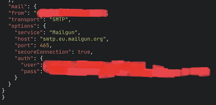

Hi, everything else is done. Mailgun is setup and verified, all fine. I’ve been over suggested posts on the forum. SSL is installed and working.
Here’s my config, all valid. No errors in ghost doctor. Been over the documentation, tried all ports, verified keys.
I get the “update:ghost can not send email, read here…”
Using digitalocean. I wonder if its an issue there somewhere, only moved to it today from google cloud.
Use StartTLS on port 587, and set SecureConnection to false, since this is the correct port for secure SMTP.
Also, check that the port is open, and not blocked by a firewall. You can attempt telnet smtp.eu.mailgun.org 587 to confirm the connection.

Your config should look like this:
  "mail": {
    "from": "support@your.domain",
    "transport": "SMTP",
    "options": {
      "host": "smtp.eu.mailgun.org",
      "port": 587,
      "service": "Mailgun",
      "secure": false,
      "requireTLS": true,
      "auth": {
        "user": "postmaster@mg.your.domain",
        "pass": "xxxxxxxxxxxxxxxxxxxxxxxxxxxxxxxx-yyyyyyyy-zzzzzzzz"

I changed the port on the example to 587, auth error, but fine apart from that. Deleted the user, made a new one and it worked. Copied it over and now it works.
