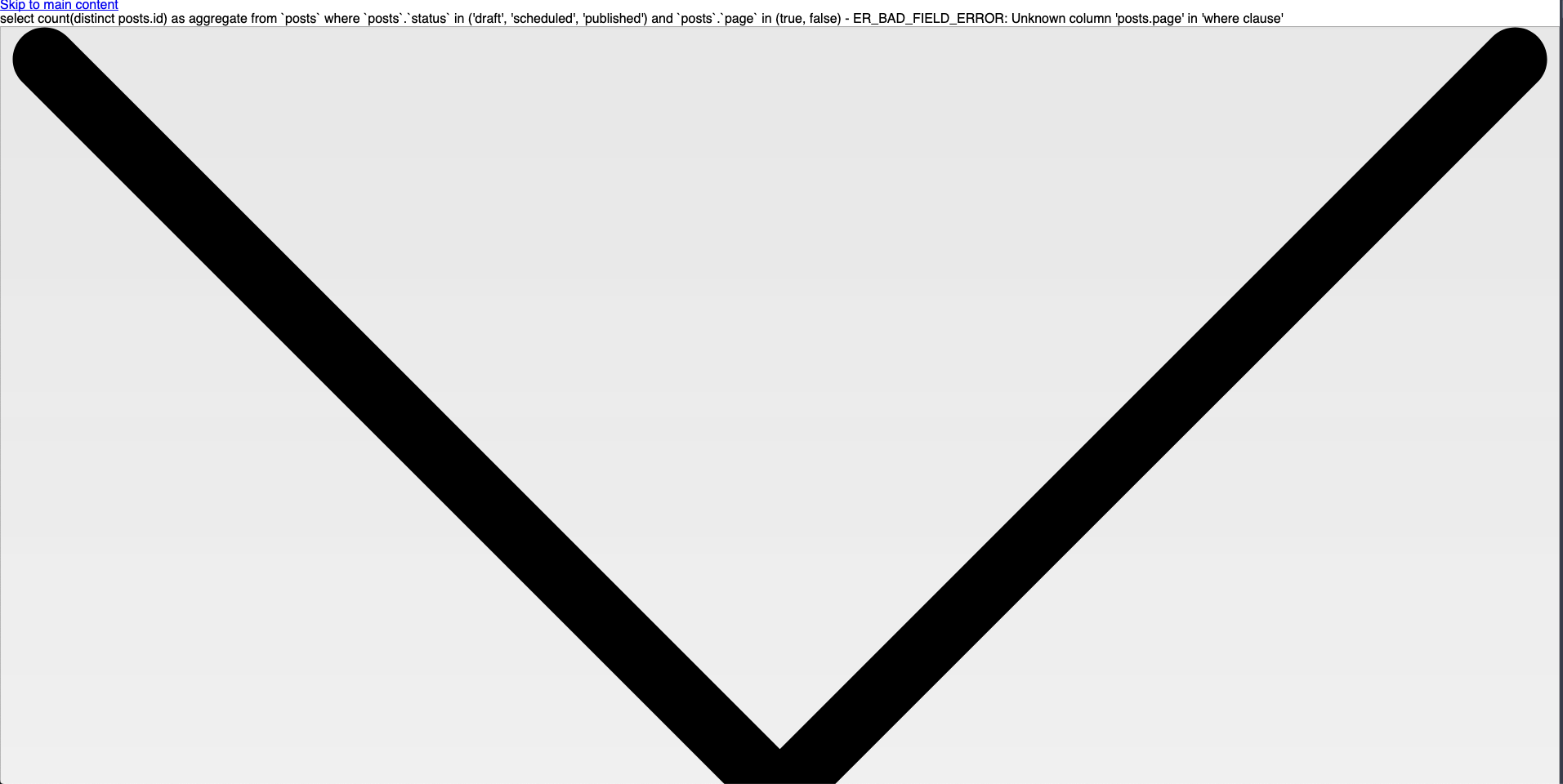

EDIT4:
I’m going back to 2.5, I don’t have time for this… guys this updates are a pain honestly… look at the admin console:
EDIT5:
I did this: ghost update --v2.7.1 and it updated it to the latest version instead of that one, looking around I found that the actual command is ``ghost update 2.7.1` anyway… the result is that it updated correctly somehow without any unexpected behaviors… I used v10.16.2 of node
