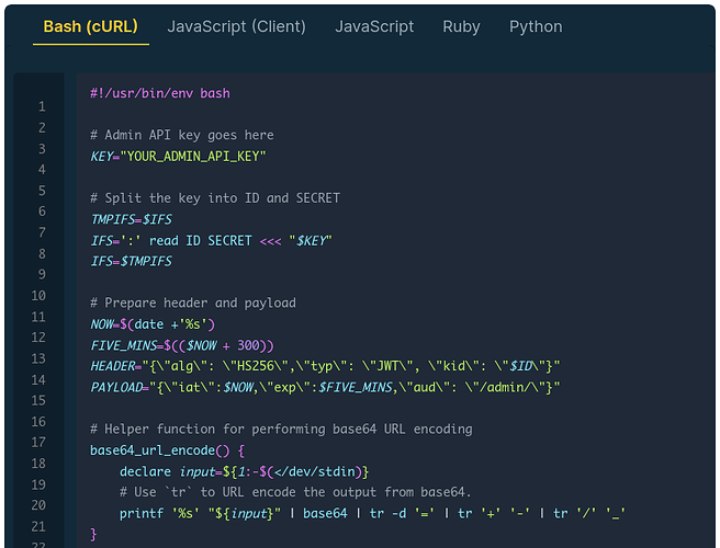

For any one else with the same problem, I have figured out what it was.
Inspecting the output of each step revealed that the bash cURL example in the docs ends up with a newline in the JWT (which I missed because it matched my terminal width).
It was turning up in the base64 encoded header payload. Here is an updated base64 function with | tr -d '\n' to strip newlines, which made it work:
# Helper function for performing base64 URL encoding
base64_url_encode() {
    declare input=${1:-$(</dev/stdin)}
    # Use `tr` to URL encode the output from base64.
    printf '%s' "${input}" | base64 | tr -d '=' | tr '+' '-' | tr '/' '_' | tr -d '\n'
I will clean-up my whole theme upload and activation script and post it somewhere shortly.
