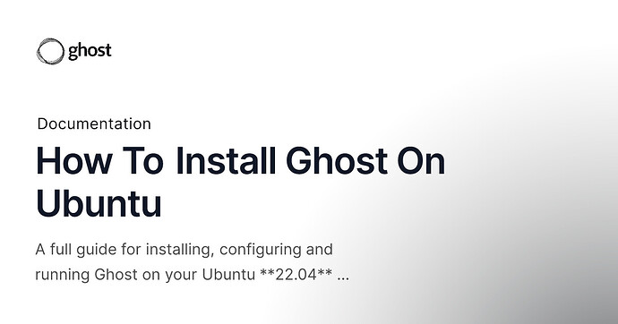

NGINX requires some changes to allow ActivityPub.
If you need it, I can supply it :slight_smile:
For ActivityPub itself, you will not need to migrate to a Docker-based installation. That should work on the “old” CLI as well, using Ghost’s hosted ap.ghost.org ActivityPub server.
Private mode is interesting. Just tested this and both notes and articles will federate − you can also read the articles in the ActivityPub reader, which is uhhh…interesting. And not what I would have expected.
However, the articles will always link to the Ghost site’s URL – in this case ghost.example.com. Since that’s in private mode, anyone following the link would just see the password field on the private page though.
Changes in your NGINX are necessary, as Karl pointed out. There’s an overview of these here:
