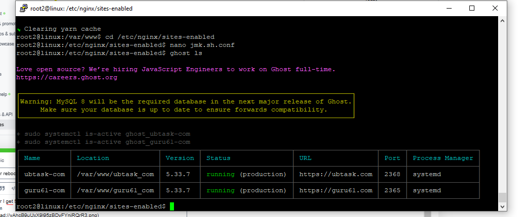

I have two websitesste or ghost running on the same VPS ubuntu
I checked the ghost ls and it seems everything is working correctly

Check that the ports used by each Ghost instance are correct in the Nginx configuration files.

You should set the listen directive to https, i.e., 443 not the Ghost port. This is only referenced in the proxy settings.
I assume you did sudo nginx reload following changes?
Also, comment out the root directive.
Whenever you have an Nginx error, a good first step is check your Nginx logs.
@Jasosn88, your site is working fine now, so what changes did you make?
https on port 443 is working but http on port 80 is still 502 and not redirecting.
