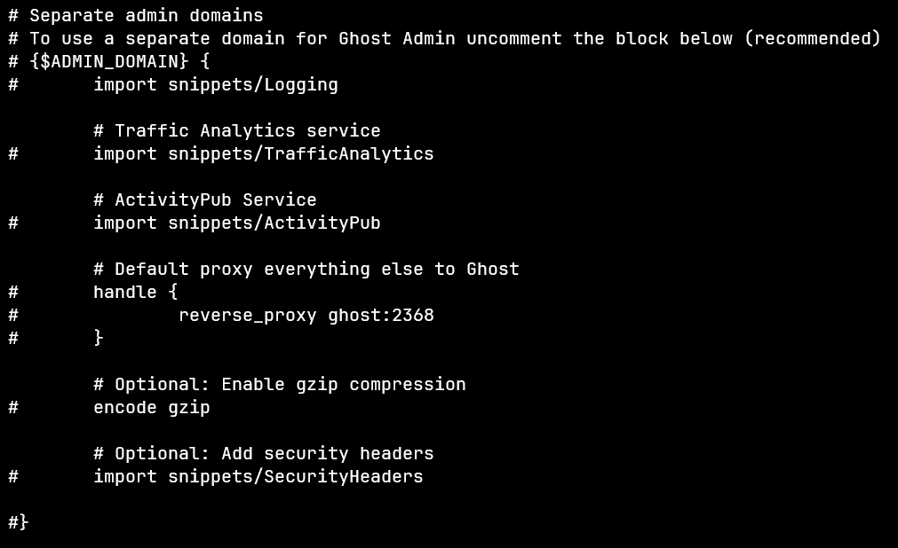

And this is my Caddy config:

Admin Caddy section is commented, I do not know why it is not showing in the post, here it ls:
