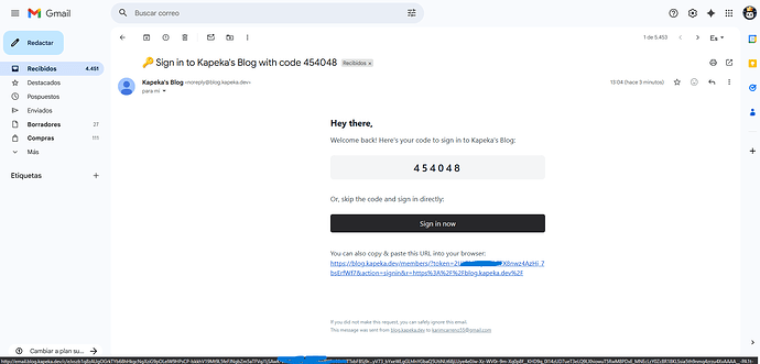

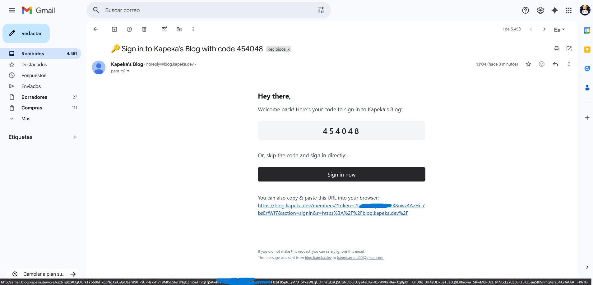

Hello folks, I have Ghost CMS self hosted and Mailgun setted up, it is all working good, but I have an issue with the transctional emails.
When a user signs in, it gets this mail:
The link attached to the “Sign In now“ black button is broken, my domain is blog.kapeka.dev, and I do not why ghost is using email.blog.kapeka.dev, which does not exists.
Also I tried using the button link but pointing to my correct domain (blog.kapeka.dev) but I get a 404 error, so I do not know where it is supossed to point the sign up button callback.
The magic link from the bottom it is working as expected, but users will tend to click the button and get an error, and not all users will try to use the bottom link so I want to solve this.
