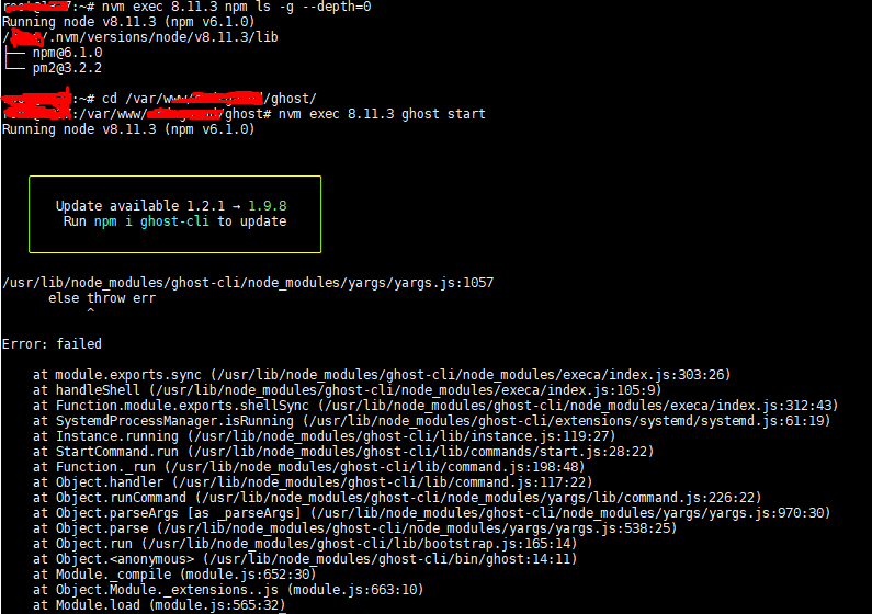

  • What’s the output of the following?
nvm exec 8.11.4 npm ls -g --depth=0
nvm exec 8.11.4 ghost start
First is to check that ghost-cli is available to the desired node version. And the second to try and run ghost with that version.
This is what I get.
From what I see in the image, this means that you don’t have the ghost-cli installed for the desired node version.
You should see something like:

You can clearly see in your picture that you are missing the ghost-cli package inside your global node-modules for the desired node version. Which I believe is the main reason this is not currently working for you. This happened to me at first because I had it installed in the other version of node.
Remember that when using NVM all node-modules live in separate folders. You can check which packages you have in each version by going to:
cd ~/.nvm/versions/node/[node-version-here]/lib/node_modules/
Or by doing the first command:
nvm exec [node-version-here] npm ls -g --depth=0

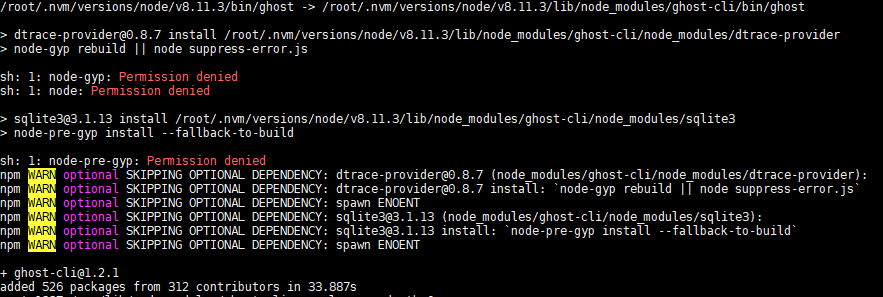

I don’t know if it matters but I got an error while installing Ghost CLI
You can see that the CLI has been installed but there was some permission issue in node-pre-gyp.
Just to be safe, you should install the ghost-cli with a user with sudo (admin) privileges, just like the docs say. Those errors are most definitely due to not installing it with sudo.
One thing to note here is that there shouldn’t be any errors during the ghost-cli installation in order for the whole process to function correctly. And assuming you’ve followed everything in the docs I believe there shouldn’t be anything else to worry about, if the cli is installed correctly.
