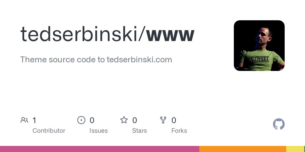

Figured out with some trial and error. You’re right Hannah, I don’t want to non-standard approach.
This worked well for me. I prob still have to create a forked repo and copy changes from my theme to that to submit a Pull Request.
But at least I can pull down changes from Casper and merge in.
Hope this helps someone!
