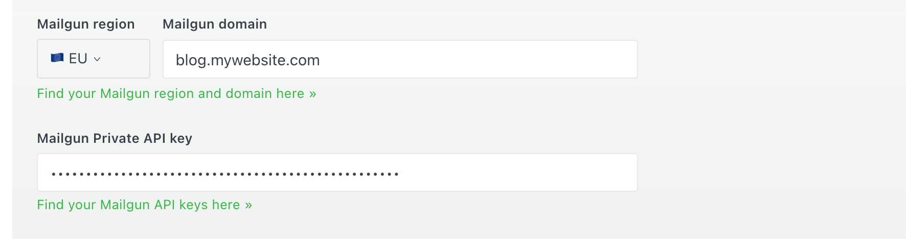

The “Mailgun domain” setting you’ve entered does not look correct - you should try using the link below the input “Find your Mailgun region and domain here” to find the correct one!

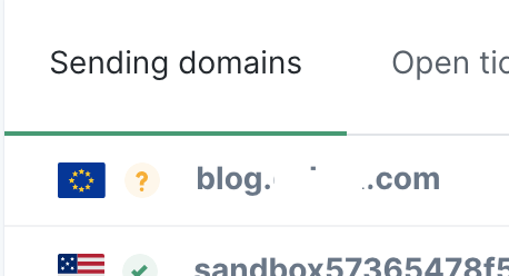

Thank you for the quick reply. This is the domain name I see in my account though
egg
January 23, 2022, 10:34pm
4
Ah - that little question mark there looks like you haven’t verified the DNS for your domain - I think you need to click on the domain and follow the instructions there!

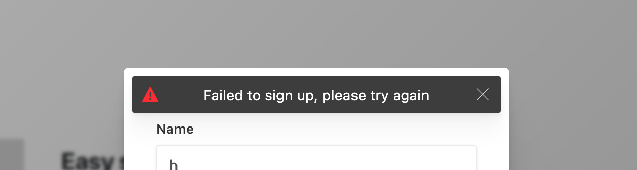

It looks like something related to Routes and SSL
[2022-01-24 09:51:04] INFO "GET /members/api/site/" 304 20ms
[2022-01-24 09:51:04] INFO "GET /" 200 73ms
[2022-01-24 09:51:05] INFO "GET /members/api/member/" 204 1ms
[2022-01-24 09:51:05] INFO "GET /members/api/site/" 200 16ms
[2022-01-24 09:51:11] INFO "GET /favicon.ico" 200 2ms
[2022-01-24 09:51:14] ERROR
CODE: ESOCKET
MESSAGE: Failed to send email. Reason: 139768439764864:error:1408F10B:SSL routines:ssl3_get_record:wrong version number:../deps/openssl/openssl/ssl/record/ssl3_record.c:332:
level: normal
"Please see https://ghost.org/docs/config/#mail for instructions on configuring email."
Error: 139768439764864:error:1408F10B:SSL routines:ssl3_get_record:wrong version number:../deps/openssl/openssl/ssl/record/ssl3_record.c:332:
[2022-01-24 09:51:14] INFO "POST /members/api/send-magic-link/" 500 61ms
