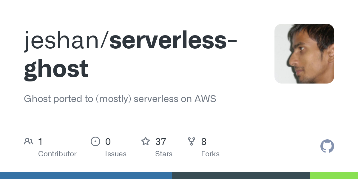

I’ve seen people asked here if we could run Ghost on serverless.
I’d like to show that I’ve got a working version!
Totally open-source over at github:
I’ve managed to integrate the various AWS services like S3 and SES.
Let me know what you think in the comments!
