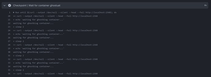

Hello folks,
I’m building Ghost in Docker since a few years now. I do a simple test to see if Ghost is running normal once I built it.
The test is : curl --output /dev/null --silent --head --fail http://localhost:2368
        name: Checkpoint | Run container ghostuat
        run: |
          docker run -d --name ghostuat -p 2368:2368 -e WEB_URL=http://localhost:2368 -e NODE_ENV=production ${{ env.DKR_PREFIX }}:${{ env.VERSION_CI }}
        name: Checkpoint | Wait for container ghostuat
        run: |
          until $(curl --output /dev/null --silent --head --fail http://localhost:2368); do
            echo "waiting for ghostblog container...";
            sleep 2;
          done;
Find the CI and the YAML here: https://github.com/firepress-org/ghostfire/runs/2675217624?check_suite_focus=true#step:14:20
Any ideas about why it’s not working anymore ?

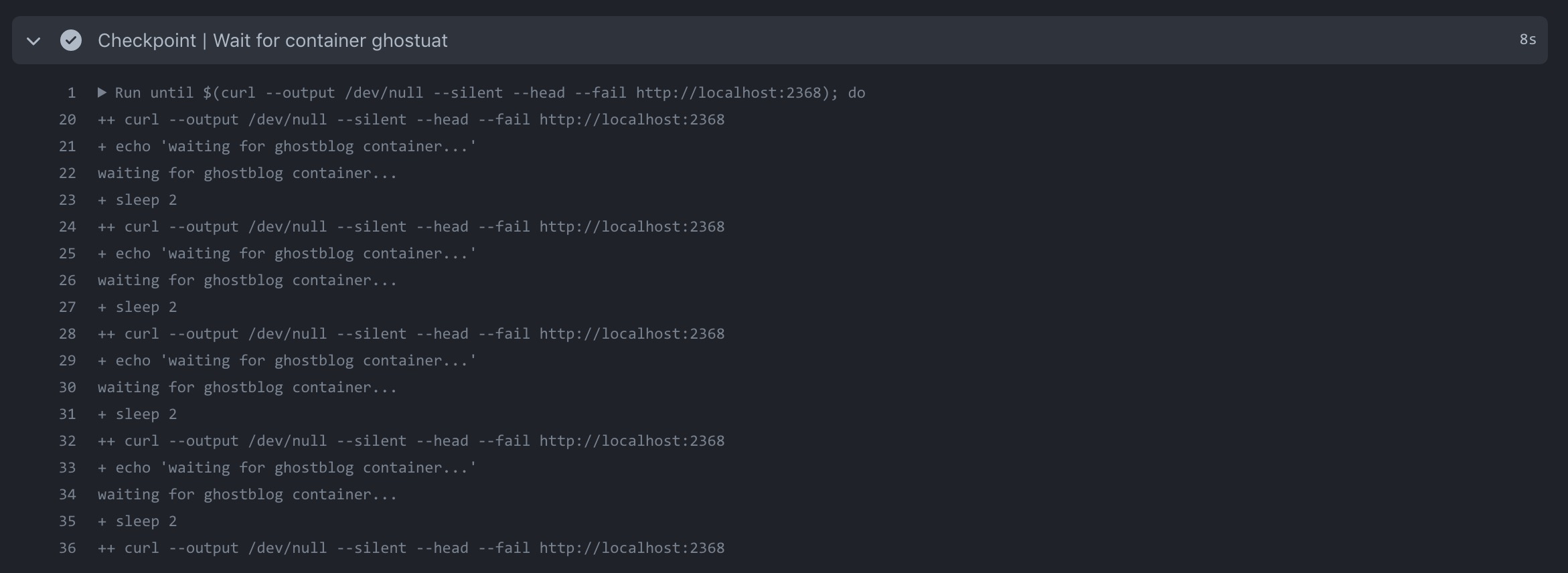

About, you see screenshots from my CI. At this point, I’m building Ghost from scratch. Meaning Stripe or site owner is not set.
The test runs a a pure vanilla docker image.
I don’t understand why curl --output /dev/null --silent --head --fail http://localhost:2368 loop infinitely since 4.6.0
What I can’t see from the CI is the output from the Ghost boot that would tell us why it hasn’t started :slight_smile:
