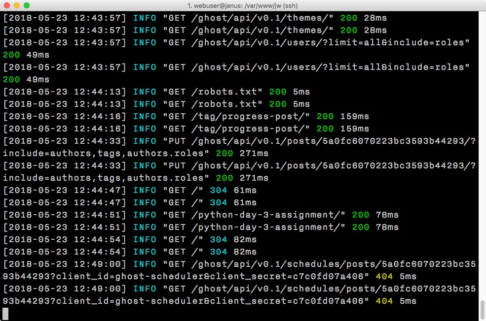

I seem to be having the same issues as @lenoir_aaron.
I however am using it on the CLI on a Linode with MySql.
I’m not quite used to all this, so I can’t be as thorough as @lenoir_aaron, but I tried to tail the log with ghost log – follow and this is what I see
[2018-05-07 09:59:22] INFO "PUT /ghost/api/v0.1/posts/5aefcb06eca0ca3d148873dd/?include=authors,tags,authors.roles" 200 168ms
[2018-05-07 09:59:27] INFO "PUT /ghost/api/v0.1/posts/5aefcb06eca0ca3d148873dd/?include=authors,tags,authors.roles" 200 122ms
[2018-05-07 09:59:33] INFO "GET /ghost/api/v0.1/posts/?limit=30&page=1&status=all&staticPages=all&formats=mobiledoc%2Cplaintext&include=authors%2Ctags%2Cauthors.roles" 200 271ms
[2018-05-07 10:04:00] INFO "GET /ghost/api/v0.1/schedules/posts/5aefcb06eca0ca3d148873dd?client_id=ghost-scheduler&client_secret=9c7101614d10" 404 6ms
The post does not post however.

@jasonbraganza In your case the request to schedule the post 404s, meaning either the post wasn’t set to be scheduled anymore, or had already been scheduled. Everything otherwise looks like it’s probably working correctly. Do you have a cache in front of Ghost?
You can view your logs in full by looking in the content/logs folder inside of your Ghost folder. I recommend trying grep -r 'schedules/posts' . in that folder to find all the requests to the scheduler to see if there are more entries.

I can’t make head or tail of this @Hannah.
Updated to 1.2.3 and tried again. have attached a pic of my log
relevant lines are at 12.44 and 12.49
me posting to publish for 5m later
[2018-05-23 12:44:33] INFO "PUT /ghost/api/v0.1/posts/5a0fc6070223bc3593b44293/?include=authors,tags,authors.roles" 200 271ms
5m later …
[2018-05-23 12:49:00] INFO "GET /ghost/api/v0.1/schedules/posts/5a0fc6070223bc3593b44293?client_id=ghost-scheduler&client_secret=c7c0fd07a406" 404 5ms

logpic
Quick note, also this is what it looks like in the editor after the publish time had past
aftersched
It’s definitely weird & confusing. However, the admin UI isn’t going to give us any hints here - it’s a separate system just showing the best thing it can with the data it has.
I can see 2 weird things. 1. the requests to the scheduler are 404ing, and 2. they’re all duplicated, which should not be the case.

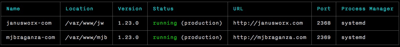

What’s the output from ghost ls on your machine?
duplicates, because I run two blogs, @Hannah ?
here’s ghost -ls both in text and as a jpg
│ Name           │ Location     │ Version │ Status               │ URL                   │ Port │ Process Manager │
│ janusworx-com  │ /var/www/jw  │ 1.23.0  │ running (production) │ http://janusworx.com  │ 2368 │ systemd         │
│ mjbraganza-com │ /var/www/mjb │ 1.23.0  │ running (production) │ http://mjbraganza.com │ 2369 │ systemd         │
ghost-ls
If you look at the logs you posted above you can see absolutely every request is reported twice at the same time.
The logs for the blogs should each go to a separate file AND if you make a request to one of the blogs, it wouldn’t make the exact same request to the other blog at the same time.
It’s like you have the process running twice.
