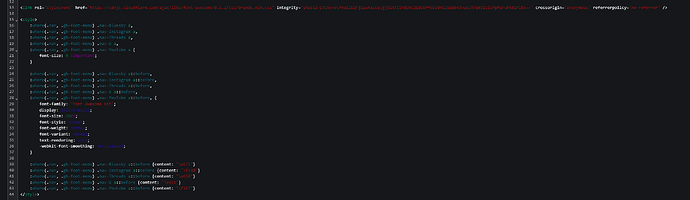

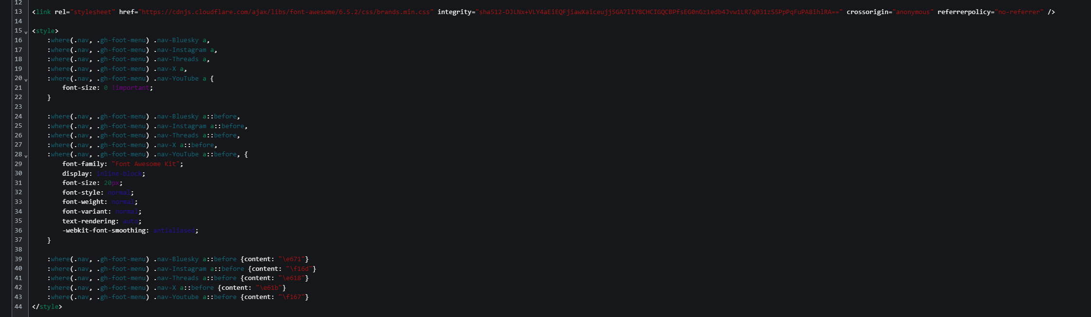

Hey, I’m a complete novice with this stuff.
I’m trying to get the social media icons to work in the footer and I’ve tried adapting what I learned in here but I’m just having no luck.
Help please!
<link rel="stylesheet" href="https://cdnjs.cloudflare.com/ajax/libs/font-awesome/6.5.2/css/brands.min.css" integrity="sha512-DJLNx+VLY4aEiEQFjiawXaiceujj5GA7lIY8CHCIGQCBPfsEG0nGz1edb4Jvw1LR7q031zS5PpPqFuPA8ihlRA==" crossorigin="anonymous" referrerpolicy="no-referrer" />
<style>
    :where(.nav, .gh-foot-menu) .nav-Bluesky a,
    :where(.nav, .gh-foot-menu) .nav-Instagram a,
    :where(.nav, .gh-foot-menu) .nav-Threads a,
    :where(.nav, .gh-foot-menu) .nav-X a,
    :where(.nav, .gh-foot-menu) .nav-YouTube a {
        font-size: 0 !important;
    :where(.nav, .gh-foot-menu) .nav-Bluesky a::before,
    :where(.nav, .gh-foot-menu) .nav-Instagram a::before,
    :where(.nav, .gh-foot-menu) .nav-Threads a::before,
    :where(.nav, .gh-foot-menu) .nav-X a::before,
    :where(.nav, .gh-foot-menu) .nav-YouTube a::before, {
        font-family: "Font Awesome Kit";
        display: inline-block;
        font-size: 20px;
        font-style: normal;
        font-weight: normal;
        font-variant: normal;
        text-rendering: auto;
        -webkit-font-smoothing: antialiased;
    :where(.nav, .gh-foot-menu) .nav-Bluesky a::before {content: "\e671"}
    :where(.nav, .gh-foot-menu) .nav-Instagram a::before {content: "\f16d"}
    :where(.nav, .gh-foot-menu) .nav-Threads a::before {content: "\e618"}
    :where(.nav, .gh-foot-menu) .nav-X a::before {content: "\e61b"}
    :where(.nav, .gh-foot-menu) .nav-Youtube a::before {content: "\f167"}
</style>

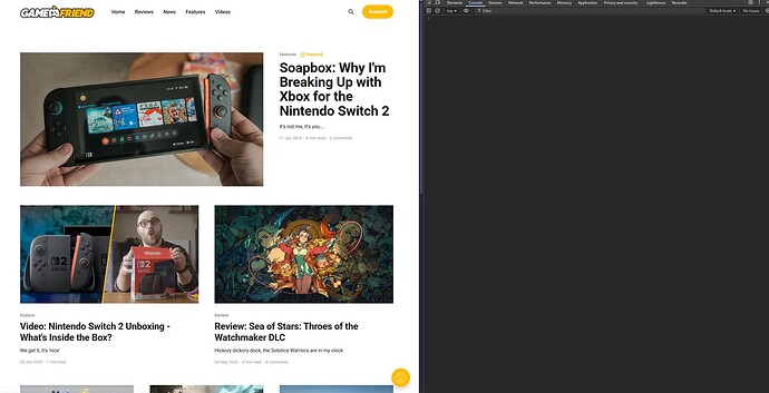

Are there error messages in the browser console?
What would that look like? Apologies, I’m really fresh to all of this. Is this what you mean?
That’s your code injection. Go to your main site (not /ghost) and press f12 to open the browser’s dev tools. Then click the console tab.
(If that doesn’t work for your browser, google how to access the browser’s console.)
Thanks! I’ve got it open and it looks like the console is empty?
Now that I’m at my desk… (drinking my :hot_beverage: before I get to coding).
I agree, I don’t see an error either. So the problem is the css selectors.

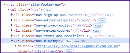

Here’s that part of your site (same F12 to open dev tools, then the ‘elements’ part)
Your selectors are wrong.
:where(.nav, .gh-foot-menu) .nav-Bluesky a means we’re looking for either a class named nav, or a class named gh-foot-menu, and then within it, we’re looking for a class named nav-Bluesky, and then within that, we’re looking for an a.
Which you almost have, except that Ghost lowercases your nav items (they’re actually the slugs). So I think you need nav-bluesky everywhere you currently have nav-Bluesky.
There’s a comma after your last a::before, that’s making the whole section invalid. Remove that.
You may also need to change your font-family to “Font Awesome 6 Brands”, based on the stylesheet you’re loading.
Finally, this theme is already using the ::before selector, to put those dots between elements in the menu. So, you are either going to need to add !important to everything (and possible add more style overrides, like for font size), or you might try switching all the ::before to after.
For anyone who comes after, the tutorial and code generator here is pretty good: How to add social media icons to your Ghost theme
(It would have avoided the capitalization problem and the comma problem at least.)
However, it doesn’t work 100% of the time on every theme out there, because your theme designer might have used different selectors or incompatible styles.
Alright! I applied those changes. It looks like this now - and it works!
