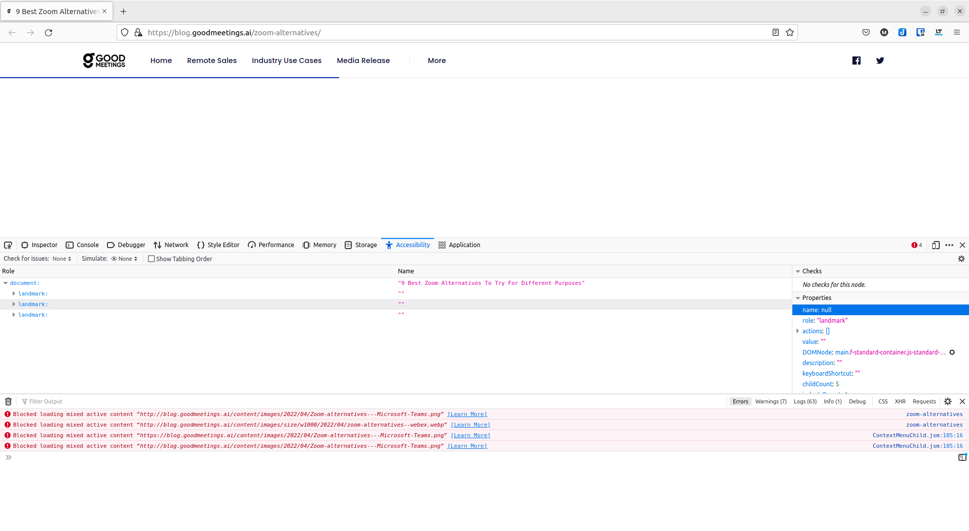

We have been using Ghost for a year now. But the issue started to come in March. When we are uploading the images inside the blog content with dimension more than 500px in width, those images don’t show on the front end. Although it shows on the backend (CRM side).

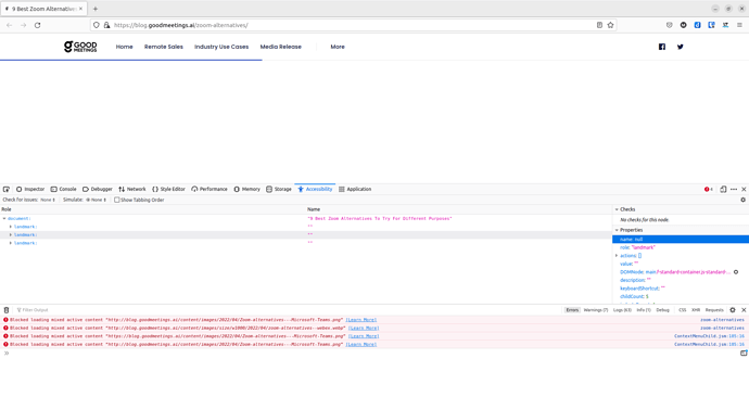

There’s not an issue with Ghost. You have mixed https and http content, and the browser won’t display this. See the errors:
Your Ghost URL may be incorrect. Run ghost config set url https://blog.goodmeetings.ai and then ghost restart.
