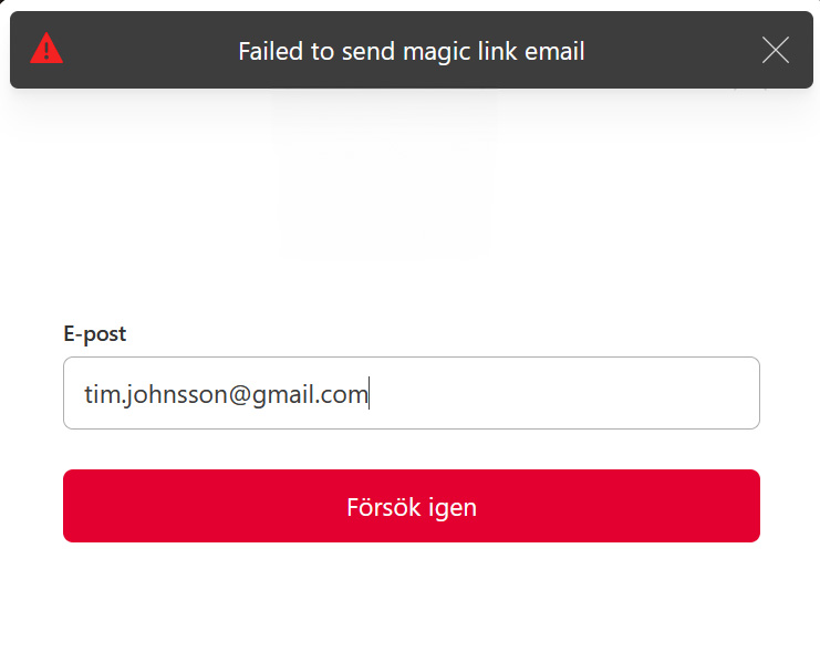

Ghost doesn’t allow members to sign up with a Gmail address. I receive the error code ‘Failed to send magic link email.’ Should I still check Mailgun, even though the email isn’t sent in the first place?
Error code:
