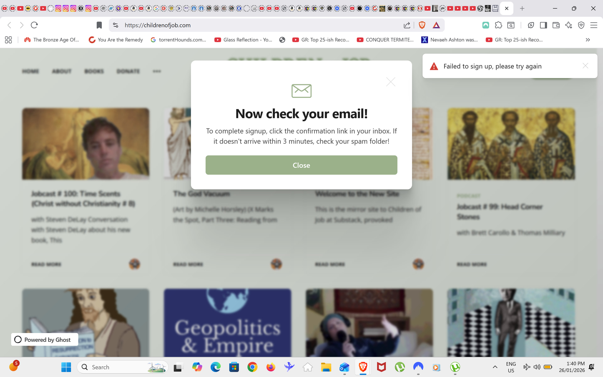

thanks, but I have about 200 paying members so unless there’s a way to send out the same email two days running to different member set then free plan won’t work
more importantly, however, there is someone in Australia who can’t even sign in to their account coz they aren’t receiving the code they need; this MIGHT be at their end but if not then obviously this will be a major problem for all new subbers:
I presume I should not need mailgun or any special extra program for him to be receiving confirmation/code emails?
You must have some method of sending transactional email (that’s the sign-in process) configured to use memberships in Ghost. The message above shows that Ghost thinks it is successfully sending email. That doesn’t mean the email is getting delivered successfully, but your tech guy would need to look at the Ghost configuration and logs and your outbound email server configuration and logs to figure out whether you have a one user problem, or a bigger problem. There are a variety of ways to set up transactional email, and no one but your tech guy knows what you’ve done and whether it’s correct.
