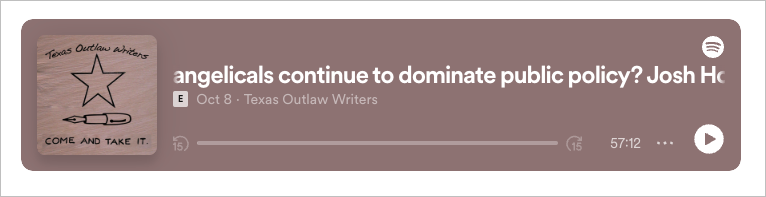

There are ways to cheat a little, though. For example, you could create an image that looks like the podcast player that just links to the real thing.
So, you could do take a screenshot like below and just link it to the episode on the web.
Let me know if that’s clear! ![]()
