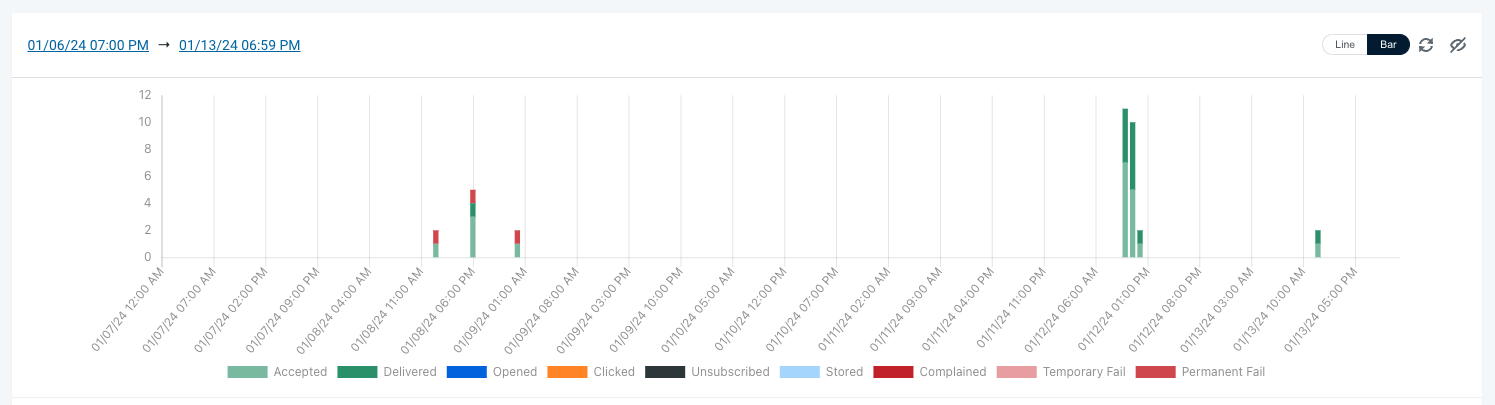

Have a look at the subject line in the very bottom of your logs:
Since the error in Ghost says “failed to send newsletter”, could it be that Mailgun isn’t set up correctly? I’d look into the Ghost logs.
You usually find them by running ghost log:
However, since you mentioned that you’re running Ghost on PikaPods, that probably won’t work. Instead, try to use their debug function:
I don’t find failed log in mailgun
I sent it yesterday and it’s all green.

[2024-01-13 21:46:08] INFO "GET /" 200 968ms
[2024-01-13 21:46:08] INFO "GET /public/cards.js?v=355e0547f7" 301 3ms
[2024-01-13 21:46:08] INFO "GET /public/cards.min.js?v=355e0547f7" 200 2ms
[2024-01-13 21:46:08] INFO "GET /public/comment-counts.min.js?v=355e0547f7" 200 2ms
[2024-01-13 21:46:08] INFO "GET /public/comment-counts.js?v=355e0547f7" 301 2ms
[2024-01-13 21:46:08] INFO "GET /public/member-attribution.min.js?v=355e0547f7" 200 15ms
[2024-01-13 21:46:08] INFO "GET /public/member-attribution.js?v=355e0547f7" 301 14ms
[2024-01-13 21:46:08] INFO "GET /assets/built/casper.js?v=355e0547f7" 200 24ms
[2024-01-13 21:46:08] INFO "GET /public/cards.js/?v=355e0547f7" 404 40ms
[2024-01-13 21:46:08] INFO "GET /public/comment-counts.js/?v=355e0547f7" 404 30ms
[2024-01-13 21:46:08] INFO "GET /public/member-attribution.js/?v=355e0547f7" 404 68ms
[2024-01-13 21:47:03] INFO "GET /" 200 486ms
[2024-01-13 21:47:16] INFO "GET /" 200 497ms
[2024-01-13 21:47:17] INFO Worker for job "email-analytics-fetch-latest" online
[2024-01-13 21:47:17] INFO mailAnalytics] Fetch latest started
[2024-01-13 21:47:17] INFO Worker for job email-analytics-fetch-latest sent a message: done
[2024-01-13 21:47:17] INFO mailAnalytics] Fetching from 2024-01-13T21:17:17.332Z until 2024-01-13T21:46:17.332Z (maxEvents: Infinity)
[2024-01-13 21:47:17] ERROR Not Found
[2024-01-13 21:47:17] ERROR mailAnalytics] Error while fetching
[2024-01-13 21:47:17] INFO mailAnalytics] Aggregating for 0 emails
[2024-01-13 21:47:17] INFO mailAnalytics] Aggregating for 0 members
[2024-01-13 21:47:17] ERROR Error while fetching email analytics Not Found
[2024-01-13 21:47:35] INFO "HEAD /" 200 478ms
[2024-01-13 21:47:42] INFO "GET /robots.txt" 200 3ms
[2024-01-13 21:47:43] INFO "GET /" 200 503ms
[2024-01-13 21:47:50] INFO "GET /members/api/comments/counts/?ids=65a2c44e64ad720001cc7834,65a012212934d10001bc1410,65a011442934d10001bc13fe,659f58b12934d10001bc13ed,659f55e82934d10001bc13de,659f55652934d10001bc13d1,659f52bd2934d10001bc13c1,659f51b42934d10001bc13b0,659f4eac2934d10001bc13a2,659f4d852934d10001bc1393,659f4c782934d10001bc1381,659f4b792934d10001bc1370,659f476a2934d10001bc1361,659f46ad2934d10001bc1352,659f46062934d10001bc1343,659f451c2934d10001bc1332,659f44752934d10001bc1322,659f43a52934d10001bc1310,659f429d2934d10001bc12fe,659f420f2934d10001bc12ef,659f413b2934d10001bc12dd,659f40072934d10001bc12ce,659f3df82934d10001bc12be,659f2a0c2934d10001bc1296,659ef29cf713bb00015313be" 200 5ms
[2024-01-13 21:48:04] INFO "GET /" 200 674ms
[2024-01-13 21:48:29] INFO "GET /" 200 729ms
[2024-01-13 21:48:34] INFO "GET /live-q-a-ep1/" 200 60ms
[2024-01-13 21:48:35] INFO "GET /content/images/size/w2000/2024/01/2019-03-31-q-a1.webp" 200 7ms
[2024-01-13 21:48:35] INFO "GET /content/images/2024/01/2019-03-31-q-a1.webp" 200 5ms
[2024-01-13 21:49:06] INFO "GET /" 200 718ms
[2024-01-13 21:49:38] INFO "GET /robots.txt" 200 4ms
[2024-01-13 21:49:50] INFO "GET /" 200 681ms
[2024-01-13 21:50:07] INFO "GET /" 200 602ms
[2024-01-13 21:51:08] INFO "GET /" 200 629ms
[2024-01-13 21:51:15] INFO "GET /public/comment-counts.min.js?v=355e0547f7" 200 2ms
[2024-01-13 21:51:15] INFO "GET /public/cards.min.js?v=355e0547f7" 200 1ms
[2024-01-13 21:51:15] INFO "GET /public/member-attribution.min.js?v=355e0547f7" 200 1ms
[2024-01-13 21:51:20] INFO "GET /public/cards.min.css?v=355e0547f7" 200 2ms
[2024-01-13 21:51:20] INFO "GET /assets/built/casper.js?v=355e0547f7" 200 6ms
[2024-01-13 21:51:26] INFO "GET /public/cards.min.css?v=355e0547f7" 200 3ms
[2024-01-13 21:51:31] INFO "GET /assets/built/screen.css?v=355e0547f7" 200 5ms
[2024-01-13 21:51:31] INFO "GET /members/api/member/" 204 1ms
[2024-01-13 21:51:31] INFO "GET /assets/built/casper.js?v=355e0547f7" 200 5ms
[2024-01-13 21:51:31] INFO "GET /assets/built/screen.css?v=355e0547f7" 200 4ms
[2024-01-13 21:51:32] INFO "GET /members/api/member/" 204 2ms
[2024-01-13 21:52:09] INFO "GET /" 200 548ms
[2024-01-13 21:52:17] INFO Worker for job "email-analytics-fetch-latest" online
[2024-01-13 21:52:17] INFO mailAnalytics] Fetch latest started
[2024-01-13 21:52:17] INFO Worker for job email-analytics-fetch-latest sent a message: done
[2024-01-13 21:52:17] INFO mailAnalytics] Fetching from 2024-01-13T21:22:17.337Z until 2024-01-13T21:51:17.337Z (maxEvents: Infinity)
[2024-01-13 21:52:17] ERROR Not Found
[2024-01-13 21:52:17] ERROR mailAnalytics] Error while fetching
[2024-01-13 21:52:17] INFO mailAnalytics] Aggregating for 0 emails
[2024-01-13 21:52:17] INFO mailAnalytics] Aggregating for 0 members
[2024-01-13 21:52:17] ERROR Error while fetching email analytics Not Found
[2024-01-13 21:52:36] INFO "HEAD /" 200 574ms
[2024-01-13 21:53:09] INFO "GET /" 200 462ms
[2024-01-13 21:53:11] INFO "GET /" 200 1142ms
[2024-01-13 21:53:30] INFO "GET /look-what-ive-got-unboxing-mystery-parcel-from-spreadshirt/" 200 57ms
[2024-01-13 21:53:32] INFO "GET /content/images/size/w1200/2024/01/2019-03-04-merch.webp" 200 308ms
[2024-01-13 21:53:33] INFO "GET /content/images/size/w2000/2024/01/2019-03-04-merch.webp" 200 598ms
[2024-01-13 21:54:11] INFO "GET /" 200 457ms
[2024-01-13 21:55:12] INFO "GET /" 200 532ms
[2024-01-13 21:56:13] INFO "GET /" 200 485ms
[2024-01-13 21:57:15] INFO "GET /" 200 582ms
This is fixed now. I had to go to Email newsletter/Newsletters/Hover over the newsletter then click Edit. Then add the correct from and to email address… I mean this should be better UX designed so that I can not set it up wrong. Please hire me and I fix ghost UX
